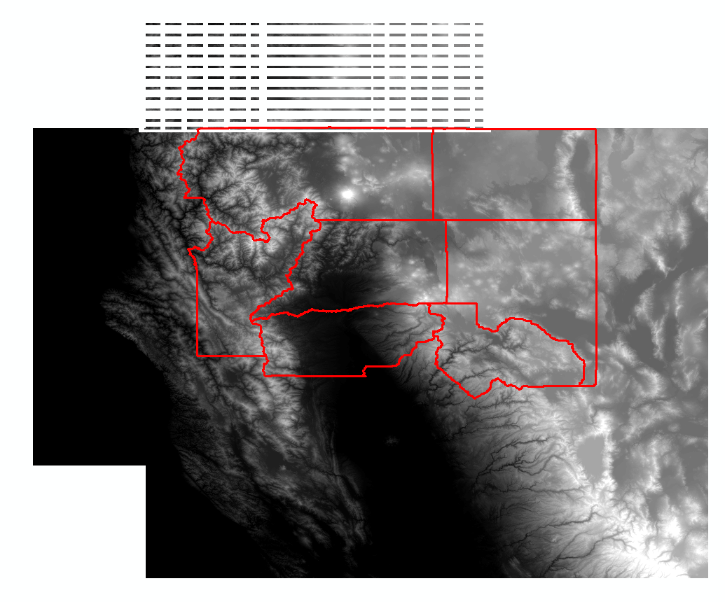

I have been tasked to mosaic 26 DEM tiles together. In doing so, I have come across an issue where that last 3 DEMs become checkerboard (see attachment) at a scale beyond 1:150,000. Zooming in below 1:150,000 everything is fine (no checkerboard), which is weird. I used the "Mosaic To New Raster" to create this mosaic. Any ideas?
Thank you,
Daniel

Thank you for the reply. Yes, I tried building overviews and that didn't resolve the issue. After several attempts, it turned out to be a memory issue. The mosaic data (or single raster) exceeded the storage capacity of the file geodatabase that I saved it in, which caused the last three rasters to be inconsistent. I simply saved the mosaic to a folder and the issue was resolved.
