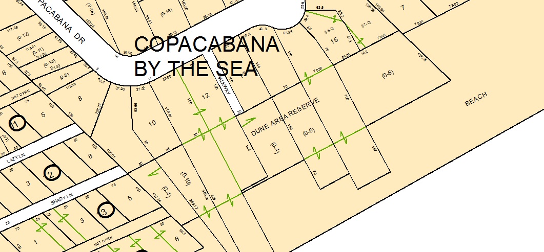

Sorry about the thread necromancy, but I found this when trying to figure out a solution for my lot lines. We are working on migrating over to a parcel fabric and I have been struggling with what to do about our "inactive" lot lines like the dashed in line lot_tax.jpg. I've attached a screen shot from our current set up, with the green lines and land hooks in green. How would I type our lot lines feature class to fit into the LGIM? lotlines.jpg
ChrisBuscaglia
Hi Anna,
I would create lots by combining lot lines and tax parcel lines, convert the lot anno to points and then code the attribute values from the points to the newly created lots.
