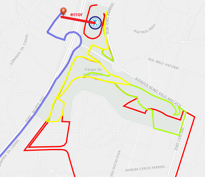

I'm using this template to find sports facilities in Lisbon. When I use the routing functionality sometimes the end point is too far from the facility as you can see in this picture:

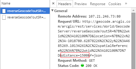

Using DevTools in Chrome I found out the problem in a reverseGeocode call:

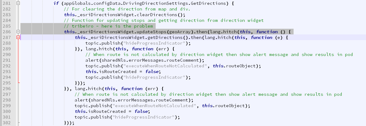

Now I need to know the exact line where this is called. I searched...searched...and found it:

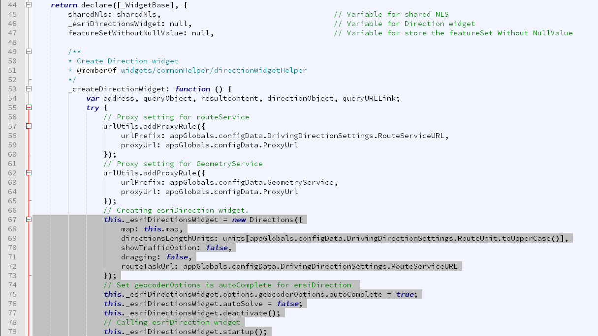

.../js/library/widgets/commonHelper/directionWidgetHelper.js
OK. Now what is the _esriDirectionsWidget?

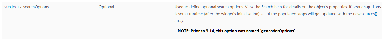

At this point the "only" thing I need is to find how to change distance parameter. I searched a little bit in the JavaScript API and I found out this:
Directions | API Reference | ArcGIS API for JavaScript
where you can find a parameter called searchOptions that prior to 3.14 was named geocoderOptions (it doesn't refer that some options are not available in the past...)
