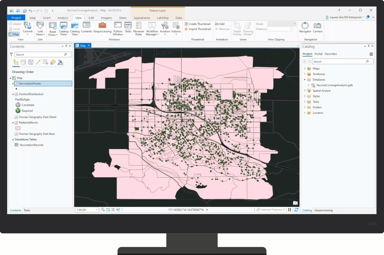

  2. Complete step 4, Prepare vaccination data, then select the Map tab on the ribbon.
  3. Click Select by Attributes in the Selection section.
  4. Confirm that VaccinationPoints are selected as the Input Rows.
  5. Click New Expression and use the Query Builder to create an expression that will select the population you are interested in.selectbyattribute.gifselectbyattribute.gif

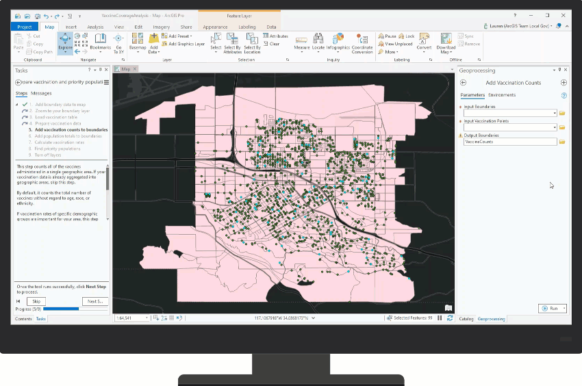

  6. Once the records are selected, complete step 5, Add vaccination counts to boundaries

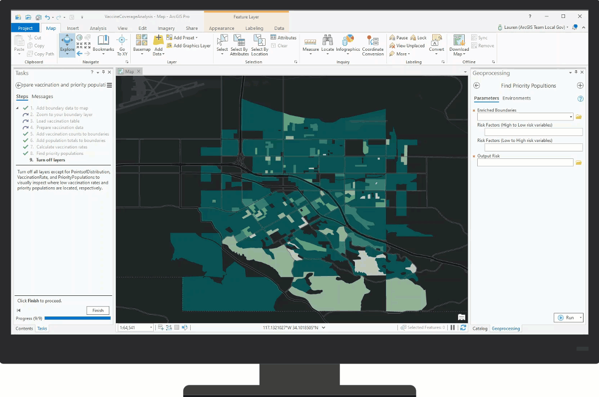

    9. In step 8, Find priority populations, select the population you are interested in as a Risk Factor. Enter all other inputs as described in the task and run the tool. The resulting layer will reflect the locations of the population you are interested in.

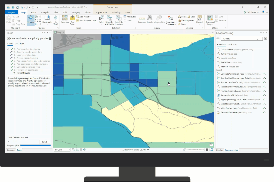

  5. Click Add Data and search for SVI in the Living Atlas. Add the Overall SVI to the map. The SVI is available in counties and census tracts. Pick the one that is most appropriate for your analysis. If you are doing an analysis on counties, pick the Overall SVI – Counties. If you are doing an analysis on a smaller geography, pick the Overall SVI – Tracts layer.addsvi.gifaddsvi.gif

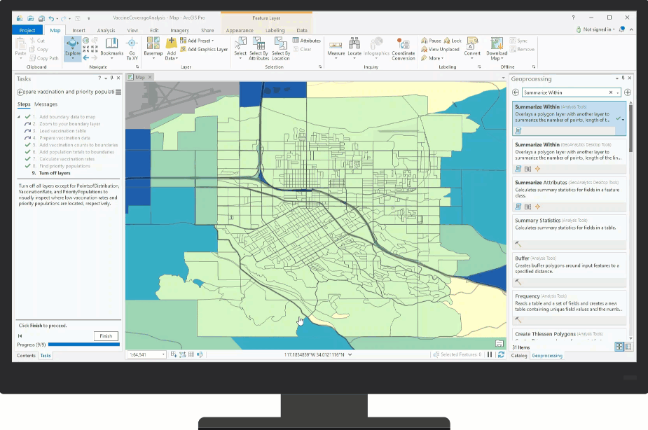

  6. Search for and open the Summarize Within tool. Enter VaccinationRate as the Input Polygons. Enter the SVI layer the Input Summary Features. In the Output Feature Class, enter “PriorityPopulations”. In Summary Fields, click the dropdown and select “Overall Percentile Ranking” as the Field and select Mean as statistic. Click Run.summarizewithin.gifsummarizewithin.gif

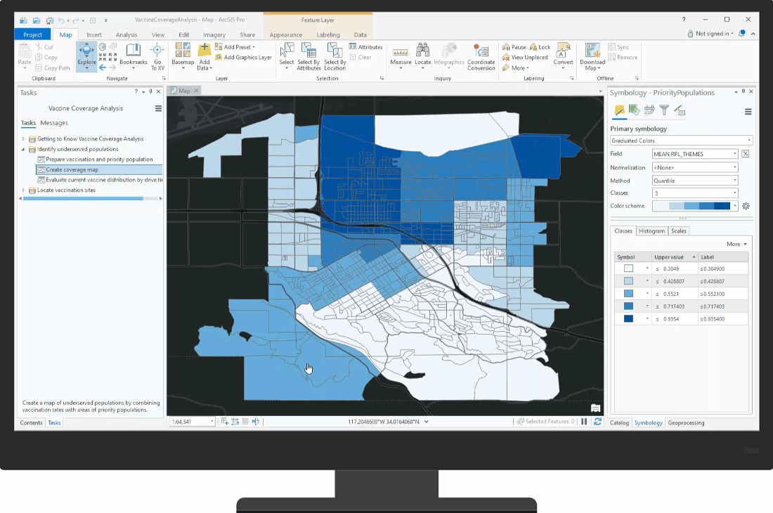

  7. Right-click on the PriorityPopulations layer and select Symbology. In the symbology pane, select Graduated Colors as the Primary symbology. Set the field to MEAN RPL_THEMES and Method to Quantile. Specify 5 Classes and select the Blues 5 Classes Color Scheme. The resulting layer will show areas of high social vulnerability in dark blue with areas of low social vulnerability in light blue.symbology.gifsymbology.gif
