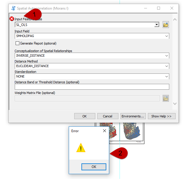

Many of the Spatial Statistics tools will not function on my computer. A red X keeps showing up next to the Input Feature Class field. I downloaded some sample data and get the same error following tutorial instructions. How can I fix this?

I have also met exactly the same problem. The red X do not give any error code  or anything when you hover over it. it actually has that mark anytime it is opened before you select the input.
What might be the cause or reason? Do I need to reinstall my program or there is a way to go round it, please help.

Another instance of this issue was recently observed with ArcMap 10.4 on Windows 10. Running a repair on the install resolved the issue in this instance. Noticed that the behavior only existed on Script tools, and extended beyond the Spatial Statistics tool set.
LarisaGISP
We were having the same problem in our GIS lab with most of the computers.  They all came from the same image but some of them didn't work.  Windows 10 with arcgis 10.4.  There was a red x next to the input box even in a blank document without any data.  Trying to run the tool gave a blank error box with no description as to what was causing the error.  DOING THE REPAIR FIXED IT.  Thank you @Martin Leavitt
