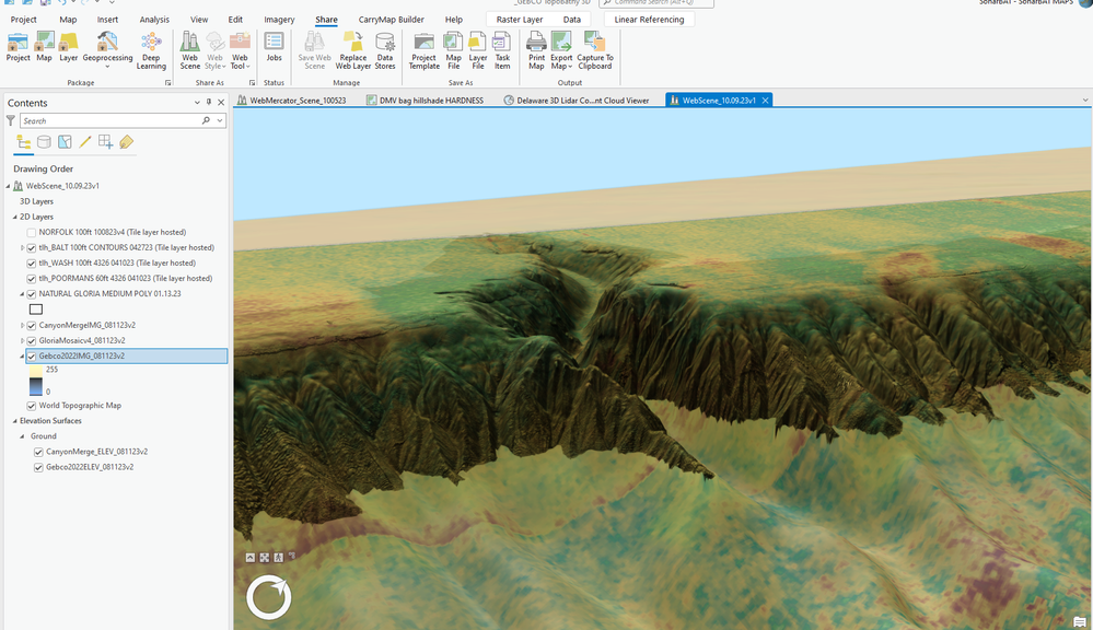

Here's how the scene displays in ArcGIS Pro (image #1):

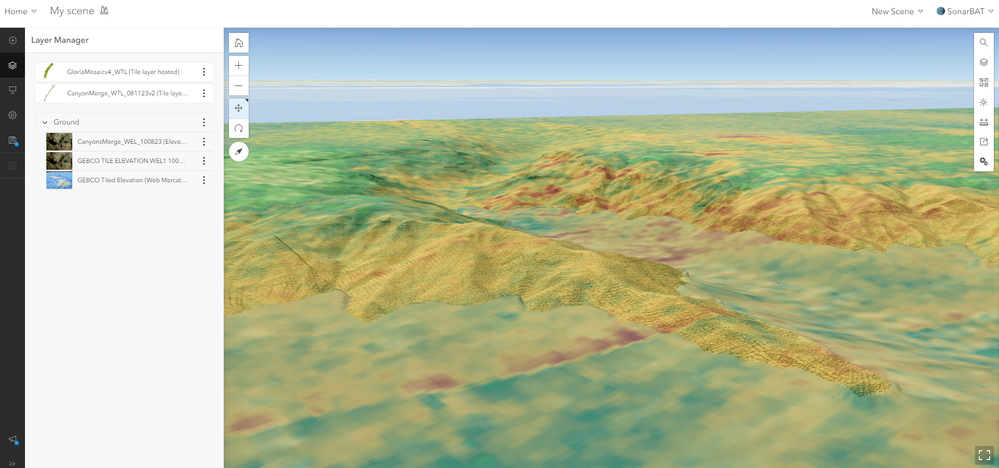

Here's how the same Scene dataset (which works in ArcGIS Pro) displays in Scene Viewer: (image #2):
The screenshot below shows how Scene Viewer displays when I changed the base Ground elevation layer from 'Gebco Tiled Elevation' to 'GEBCO 2021 Global TopoBathy Elevation at 3.5x Vertical Exaggeration':
~ Why does my custom elevation layer sit up on top an extruded platau instead draping over top of the Gebco TopoBathy 3.5 Exaggeration elevation layer?
~ Why does Scene Viewer honor the exaggerated elevation attributes shown in the Gebco TopoBathy Exaggeration elevation layer but the elevation attributes are ingored in all other types of elevation layers? (including the Ersi hosted Gebco Tiled Elevation and TopoBathy 3D for example)? (image #3)

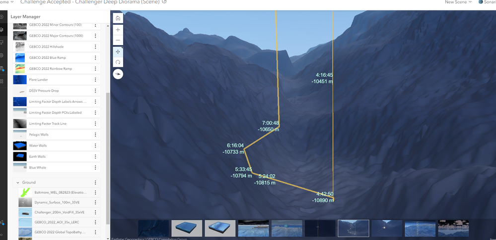

Challenge Accepted - Challenger Deep Diorama Scene: (image #4)

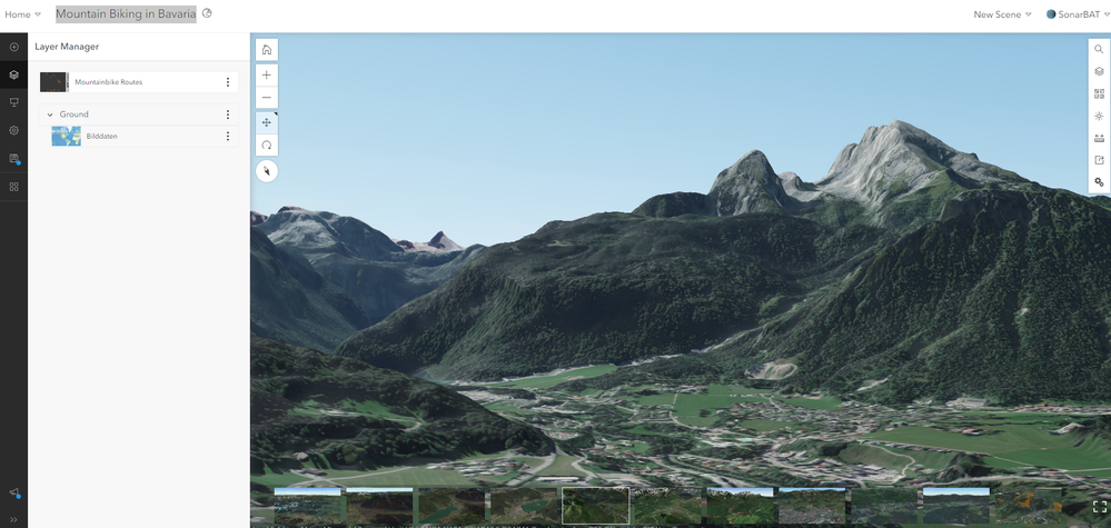

Mountain Biking in Bavaria Scene: (image #5)

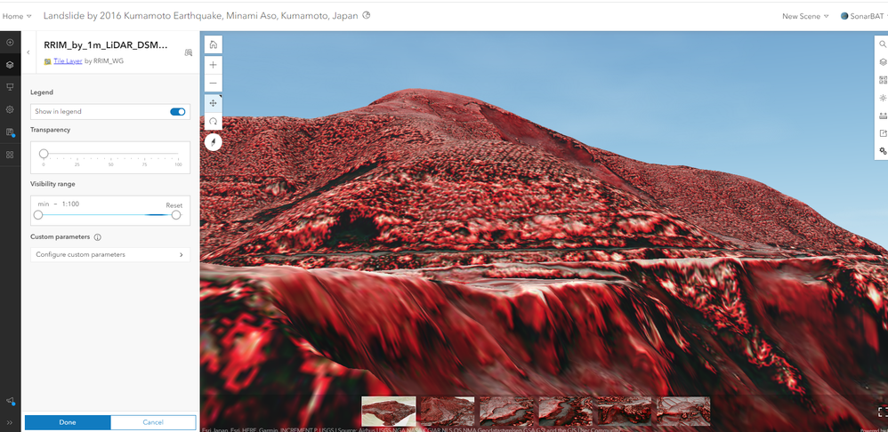

Landslide Scene: (image #6)
