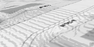

I have a hosted DEM ImageServer on ArcGIS Enterprise 10.6.1. When I use the DEM as the ground elevation in the ArcGIS Online Scene Viewer, the ground is not smooth as you can see in the image below.
DEM with tiled basemap over it in ArcGIS Online Scene ViewerMaximeDemers_0-1695743056832.png

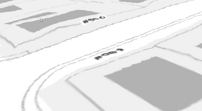

However, the same DEM with the same basemap in the ArcGIS Enterprise 10.6.1 Scene Viewer display smoothed correctly
DEM with tiled basemap over it in ArcGIS Enterprise 10.6.1 Scene ViewerMaximeDemers_1-1695743056839.png

AndreasUlmer
ArcGIS Online enabled terrain shading in a recent release:
https://developers.arcgis.com/javascript/latest/4.26/#improved-terrain
10.6.1 did not have terrain shading yet.
Our assumption is that the terrain data is actually the same, i.e. already not smooth 10.6.1, but the steps are not visible without terrain shading.
To doublecheck this assumption we'd need some more info:
* is this a custom DEM? Or the default world elevation service provided by Esri?
* if custom, is it possible to share a url to the layer / the service?
* if not custom: please share the exact location where the problem occurs so we can investigate further. You can do this in SceneViewer Share Dialog, Share link, which will include viewpoint in the url.

AndreasUlmer
Assumption confirmed:
Data is the same in older versions (e.g. 10.6.1): The same "steps" can be seen on the grid when basemap is disabled.
In older versions those steps were not or barely noticeable due to the flat shading where surface normals were ignored. With the new terrain shading (think dynamic relief) these terrain details become visible.
So the problem lies in the data / the DEM, or the way it was created.
I'm not an expert on DEMs, I would say though that the data resolution is lower than the resolution of the DEM, and that could create these step-like artefacts. I'm also not clear if there are additional interpolation options which allow to control this behavior. I would try to create the DEM with a lower resolution, which matches the resolution of the source data.
For more detailed help I recommend to ask again in the ArcGIS Pro section, or whichever product is used to create the DEM.
