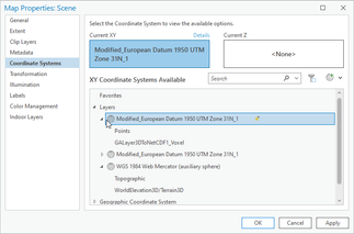

When I opened the ppkx I noticed that the Scene itself has a different Coordinate System than the voxel, that's why it was not rendering. The Scene is taking the Coordinate System of the 2D Layers. You can change the coordinate system of the Scene in Pro and then Share it as a Web Scene. Here are the steps I did to publish it as a web scene with the correct coordinate system.
  1. In Pro, Right click Scene in the Contents Pane and go to Properties
  2. Go to the the Coordinate Systems and choose the Coordinate System of the Points and Voxel Layer. In this case the Modified_European Datum 1950 UTM Zone 31N_1ArcGISPro_NyGbvpTIn4.png
  3. Click on Apply and Ok
  4. Delete the Topographic (2D Layers) and World Elevation (Ground) layers. These layers are in a different coordinate system and will throw an error when Sharing the Scene as a Web Scene. Something like the image below: ArcGISPro_XmmxBjyTvE.png

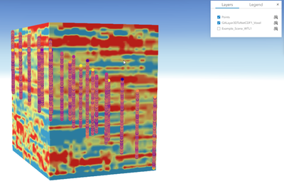

Here is a sample of the published web scene using the attached ppkx.
Let me know if the steps above helps.

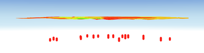

I have created a package with synthetic data; is that okay?
I believe my problem arises from working with my own personalized coordinate system. Even when I manage to reproject all features to WGS84, it still doesn't work in ArcGIS Online. When I load it into AGOL, the voxel doesn't align with the points, like this:
and the symbology of the points doesn't show up either.
I just want to learn how to do all the process, from the beginning correctly because I'm going to do it very often.

To keep track for future reference, here are the steps I followed to set up a fully functional Web Scene:
  1. I reprojected all features and rasters to WGS84 and set the vertical datum to "None." Otherwise, I wouldn't have access to base maps.
  2. To display raster surfaces, I set the elevation layer to "ground." Unfortunately, it's not possible to show multiple surfaces (e.g., water table, bedrock, topography) simultaneously, so each surface must be toggled on and off in the Web Scene as needed.
  3. The points in the Web Scene initially displayed incorrect elevations, so I manually adjusted them in ArcGIS Online.
  4. When importing features into the scene, remember to add each 3D feature layer individually. Simply opening the Web Scene does not display the correct symbology for 3D points.
Well, I think that covers everything! This is mostly for my own reference for next time. 😄
