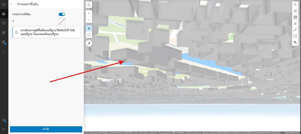

We are interested in authoring underground web scenes for utility data. However, the 3D buildings in Esri's 3D Basemaps for Scene Viewer are below ground. This makes the buildings appear 'sunk'.

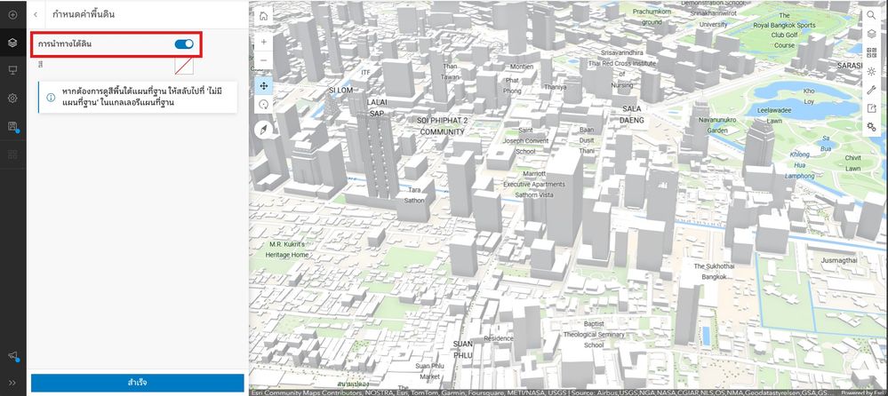

First, I enable Underground Navigation.
Enabling Underground navigationEnabling Underground navigation
Then after panning underground, notice how the buildings appear below ground (sunk). Turning off the ground elevation service does not help.
The buildings appear sunk (below ground)The buildings appear sunk (below ground)

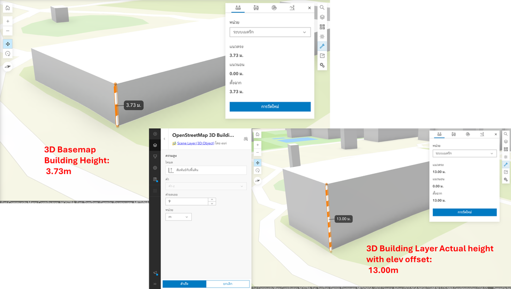

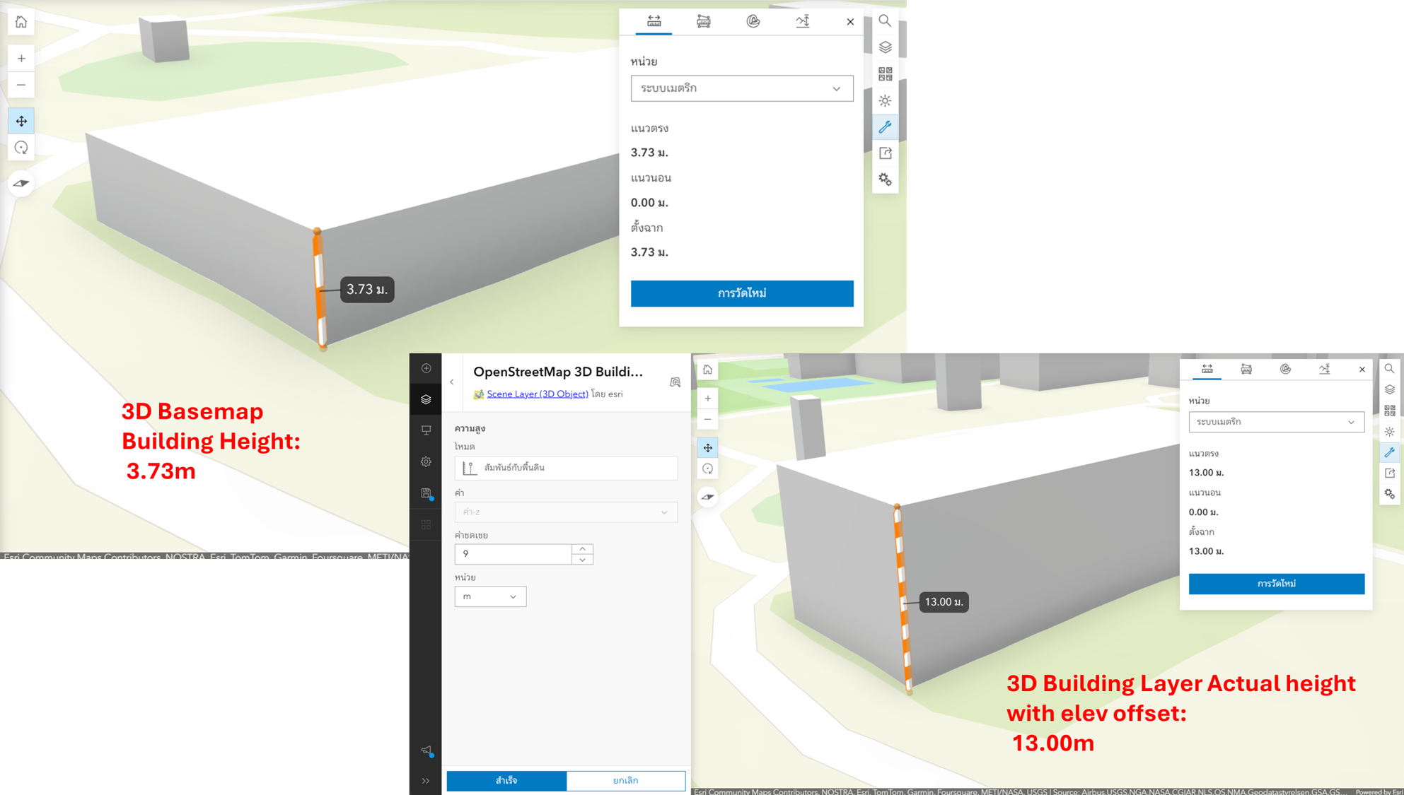

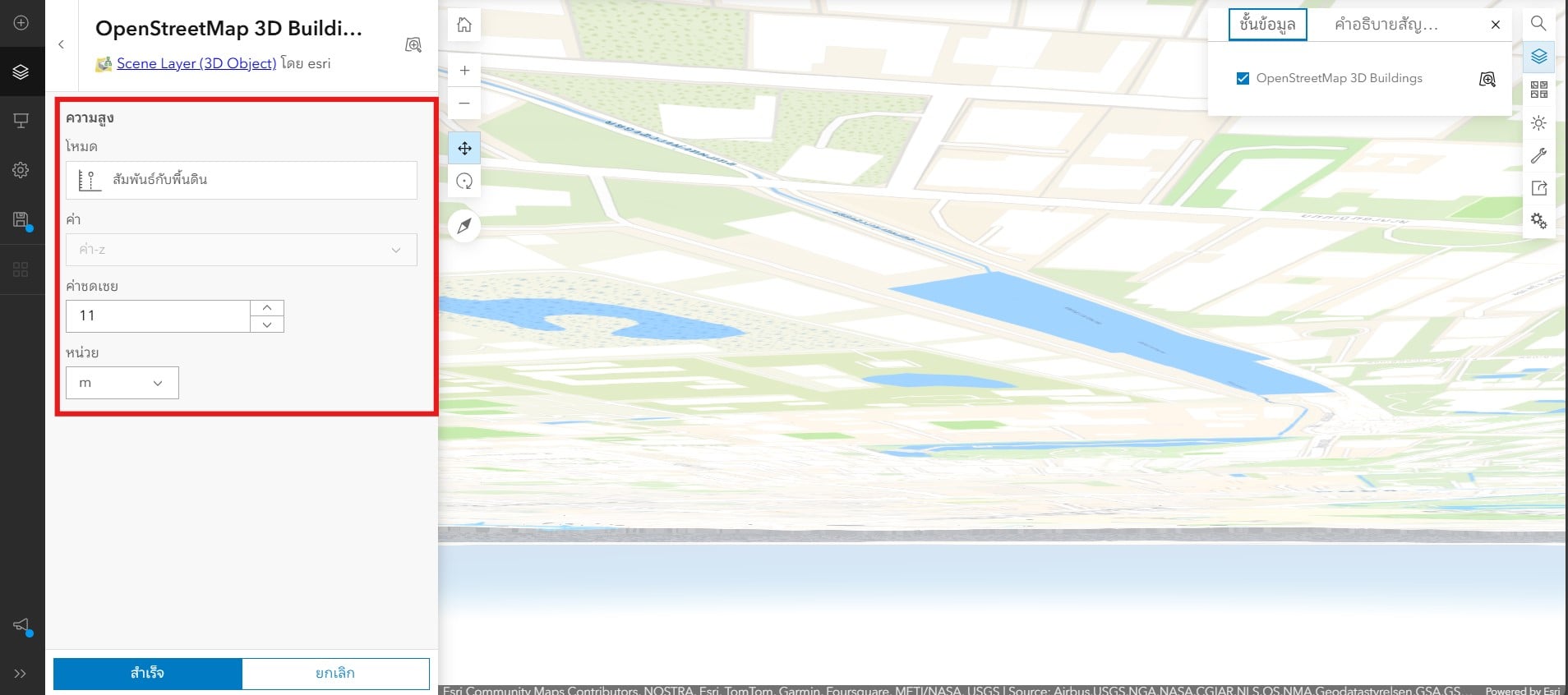

Alternatively, if I add the 3D Buildings service into the scene, I can utilize elevation offsets to make the building appears above ground.
It would be better if the buildings that come with the basemap support the same option. It would also be best if the buildings are actually on the ground by default (not relative to ground).
