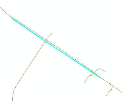

Sounds like your saying that if a known distance from an intersection, you want the routes zero point to start there and would it also stay that same distance if the intersection point moved or keep the same x,y? (colin.png)
For us, if we have to represent the other side as shown above we would create the whole route starting at the end of the other route and ending at the beginning of the other route. (NC_divided_route.png)

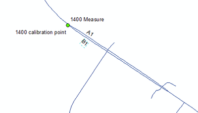

Not quite. Because we only have a couple divided sections and they are very short, we are most interested in matching the measure of B1 to the A1 upchain route. NC's example makes a lot of sense, but measures calculated that way would have no practical meaning for us and would be a lot to manage for this tiny use case.
The idea would be to have B1's start calibration point, calibrate to the measure of A1 at the intersecting point.
Like I said I'm pretty sure this is not supported, just hoping someone can confirm.
