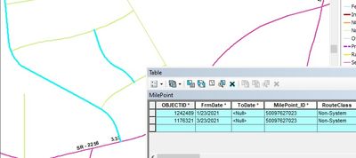

I misspoken on the using the Create Route tool to create overlapping slices (must have been a previous version/patch cause I recall us doing that) as the software will not allow you to create the route but you can use the Reassign Route tool to unintentionally create the issue at 10.5.1 SP2.
Objectid 1242489 was created this morning, the existing route (50097643023) had a From Date of before 3/23/2021 and I used a From Date before the current timeslice 1/23/2021 to reassign the route.
Our timeslice look as such now:
50097627023
FrmDate 1/23/2021
ToDate <null>
50097627023
FrmDate 3/23/2021
ToDate <null>
50097643023
FrmDate 9/15/2020
ToDate 1/23/2021
