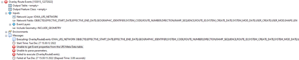

I am attempting to overlay several events against our network layer and keep running into the following error:
Any ideas?

The Overlay Route Events GP tool requires inputs to be part of an LRS dataset so you will need the LRS_ tables in your local staging geodatabase.

Hi BJ - have you tried running the tool in a model? I've only been able to get this tool to work inside a model.

Can you verify whether the GDB connected user you have specified for the connection to the LRS network and events has read access to the Lrs_* business tables (Lrs_metadata, Lrs_EventBehavior, Lrs_Locks etc)...

The events are in a local staging geodatabase (not connected to the R&H deployment) separate from the LRS. It appears that I would need to import these into same geodatabase in order for the tool to work?
