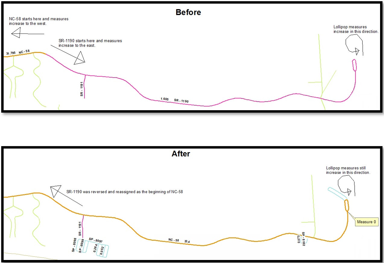

            1. Lollipop route – Reverse and Reassign operations
In this example a preexisting lollipop route needed to be Reassigned.  To achieve the desired end result measures were first reversed, then the route was reassigned.  The result is that the lollipop is now the beginning of a much larger route.  The route measure anomalies are turned off in these images, but there is a point anomaly in the lollipop where the route intersects itself.

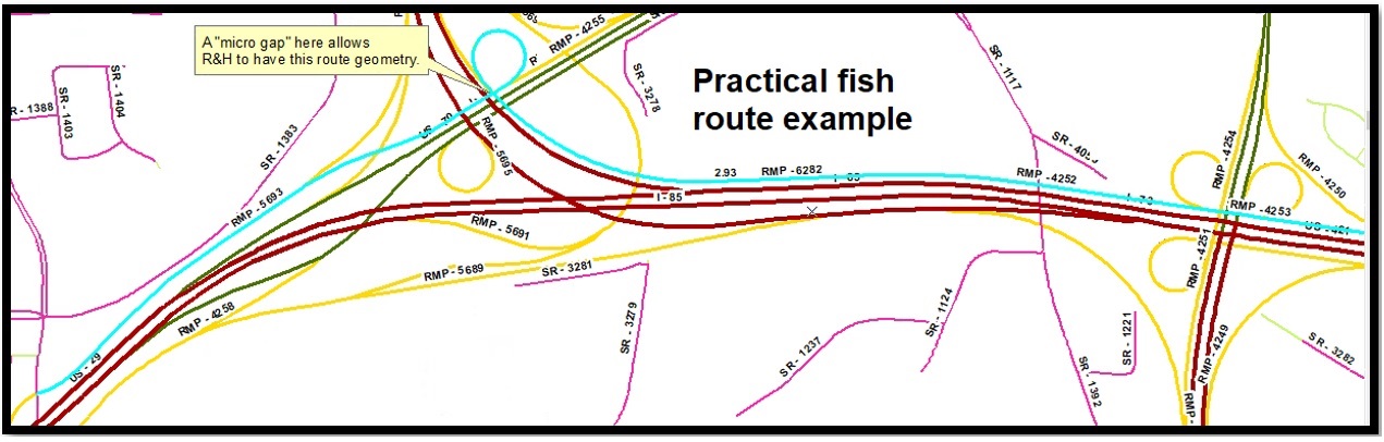

2. Fish route – Practical example
In this example a route representing an Interstate ramp is a fish route. There are many other similar ramps in neighboring interchanges. These are all currently employing the “micro gap” workaround for fish routes.

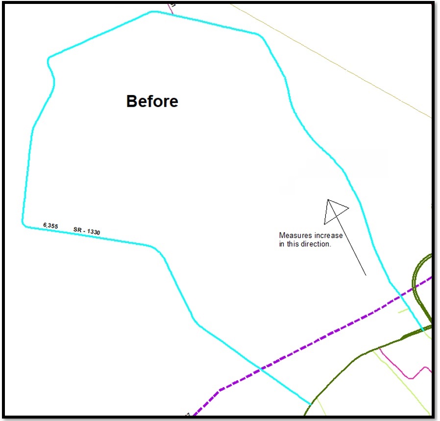

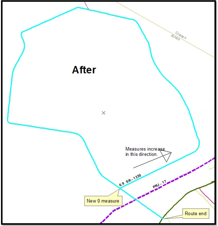

4. Lollipop route – create via Realign operation
In this example a route will be Realigned so that it becomes a lollipop route. All other lollipop routes in the ALRS came to be via a Create operation or via the original data load.
