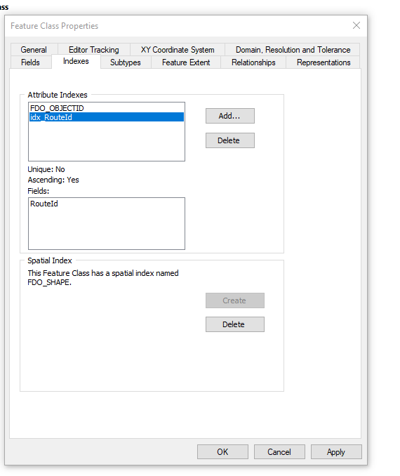

Should I simply delete the created Redline feature class and create it manually? If so, how should I set the Index properties? Below is a screen shot of what was automatically generated when I created the ALRS:

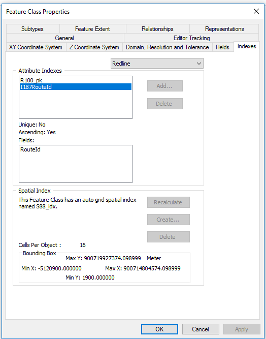

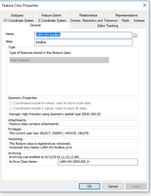

Below is a screenshot of the Redline Z and M value and Indexes settings in our current production database:
(Notice both Z and M values are enabled)

Although there seems to be some ambiguity in our docs, the redline feature class should not be M or Z enabled if you choose to use route redlining in the Roads and Highways Event Editor. To resolve your issue you could create a new redline feature class and replace the old one. In order to make this GDB feature class swap you'll want to be sure there are no services running that contain the current redline.
