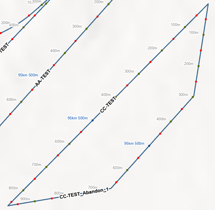

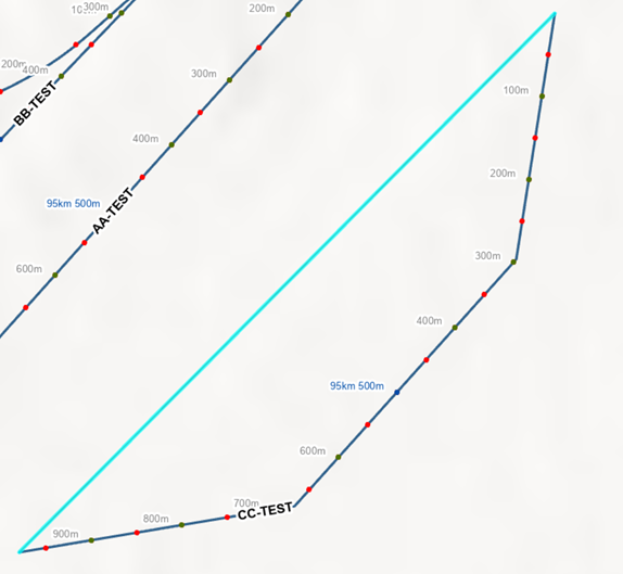

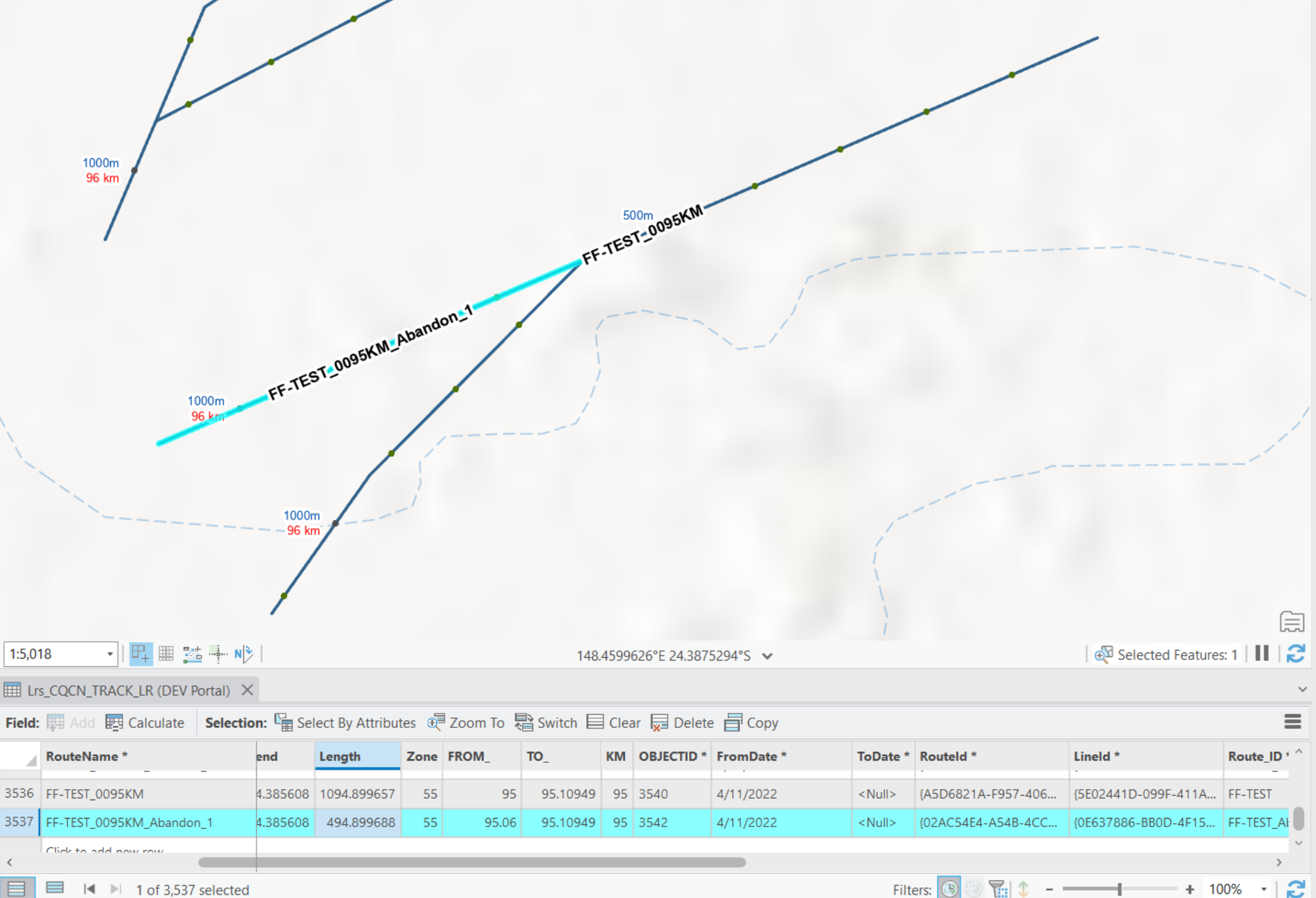

In the picture below I have a route named CC-TEST_0095KM which is labelled using its line name (CC-TEST).  I have digitized a centerline which I am going to use to realign CC-TEST_0095KM to be a straight line.

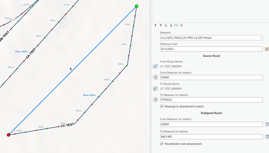

To do that I use Realign Route:
and I get this result which looks like it has the correct measures on both the abandoned and realigned routes:

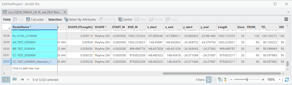

My LRS data has about 10 Attribute Rules set up with an Insert trigger to calculate among other things a Length field.  I do not use an Update trigger as well because when I have tried that I get various errors from editing which has led me to believe that Location Referencing does not like them.  When I looked at the rows for the above routes in the Attribute Table I noticed that Length was the same for both the abandoned and realigned routes:
The SHAPE.STLength() field looks like the right values (which are in decimal degrees).
It's like the fields have been copied from the abandoned route to the realigned one, perhaps after the Attribute Rule triggers were run.

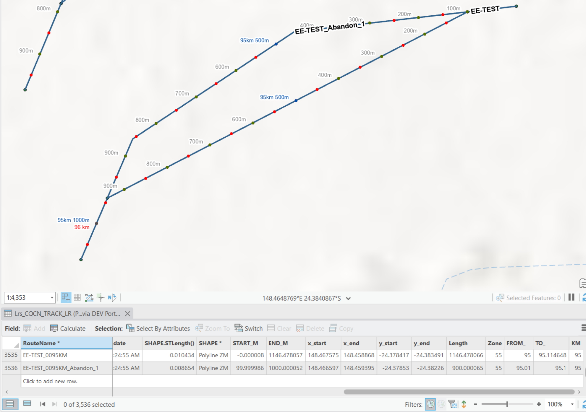

A second Realign Routes test is illustrated below:
For that I get this result.
The Length of the abandoned route is 900m which is what I would expect because I realigned from 100m to 1,000m.  However, the realigned route is 1,146m which is the same as the original route rather than its new Length.  Once again, the measures on the map look like they are being set correctly and it is the extra fields, that Attribute Rules are supposed to maintain, which appear not to be doing their job correctly.

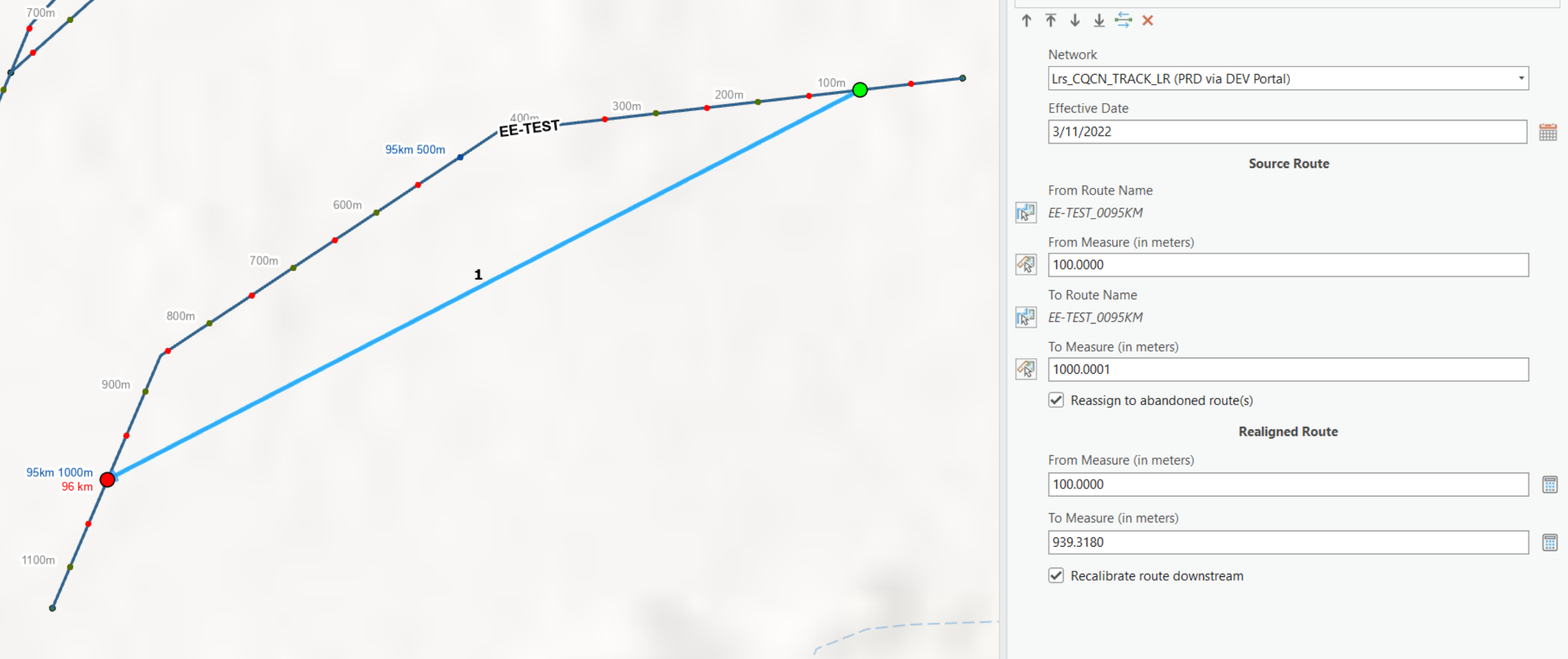

A third Realign Routes test is illustrated below:
The Length of the abandoned route is 494m which is what I would expect.  However, the realigned route is 1,094m which is the same as the original route rather than its expected new Length of 1,124m.  Once again, the measures on the map look like they are being set correctly and it is the extra fields, that Attribute Rules are supposed to maintain, which appear not to be doing their job correctly.
