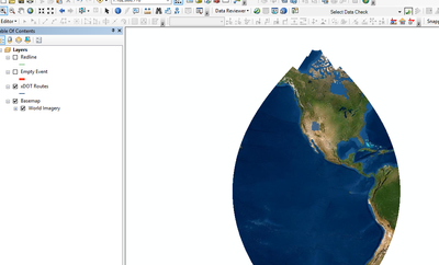

Outside of those questions, the LRS service you are using for webmap configuration usually defaults to the zoom scale the MXD you published from was set to. You might want to check on that MXD. Additionally, do you have any feature layers in your map without a spatial extent set? Sometime empty event layers can cause this if you set the initial extent to the full map extent:
