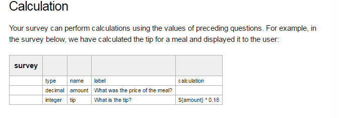

I can reach back into previous questions in the current survey.  So if your survey has three questions, Number of persons sampled building , and number of persons in residential building I can sum those values and pre-populate the third question called estimated population and hide it from  the survey.
So my question to you are you trying to do this the first way or the second way.  To do this the second way,  refer to this link which explains how to create a calculation from previous questions using the XLSforms Calculation Column... Survey123 for ArcGIS support for XLSForm
