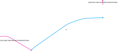

I am trying to create a new route on a line network between two existing routes as you can see in the screenshot below. The existing two routes (purple line in the image) are on the same line and the new one (blue) should be on the same line as well. However, Create Route tool does not like this and throw an error: "Cannot create a route at the start or end of a gap of an existing route in the same line". It seem to say it does not allow adding a route in the gap of an existing single route. Those two existing routes do not have any gaps. But there is a gap between those two routes. How can I accomplish what I need to do?

It's a byproduct of temporality. You cannot create a new route of an existing timeslice. Looks like you still intent to have a gap when all is said and done is that correct?
I don't like gaps as they do nothing but cause problems but yet they are valid to have. We try not to create and then not mess with if we have to. We use Euclidean Distance for our gap calibration. Your measure may act differently depending on the setting and how you model your lrs.
One method I did today on 10.8 that looks good measure wise to completely fill in the gap that I could quickly see was to reassign the blue route with a later date then purple and blue to the purple route. Selecting the first gap segment as my target route. The measures populated matched the first gap segment.
Personally I probably would have created a new route with the correct date along the gapped section to be filled and second gap segment. I would then have retired the second gap segment from the start of the gap section and then reassigned the new route to the existing route with the same from date.
The image has the top half with the method I first tried and the bottom half shows the second method. Hopefully this all makes sense.

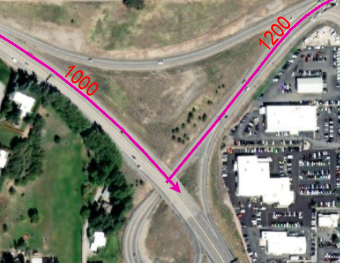

Here is another detail I should mention. At the start and end of the new route I am trying to create there are small gaps between the previous and next routes. The gap exists because this particular state route stops at the overpass and restart under the overpass. The picture below shows an example. The red numbers are the line orders.

I went through the tech-support and they filed a bug for this issue: BUG-000149190.
