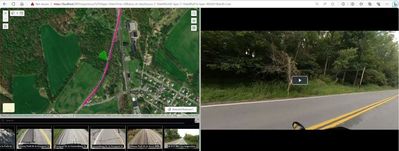

I’m searching for a way to capture features on a roadway using street-view imagery.
In the attached example, I marked a guardrail (linear feature) and a Sign and a Signpost (point features). I’d like to capture to Lat/Log of the features, measure the length of a linear feature as well as some attribute information (type, condition etc.)
I’m aware there are many companies out there that develop software just for that – asset extraction - but I’m looking for a less expensive solution, one that I can use Esri product such as ArcPro or Experience Builder. I’m open for suggestions. TIA.

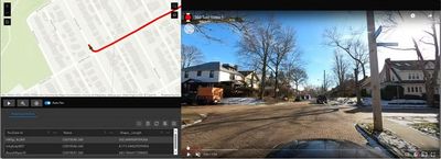

Here are two user-friendly low cost Experience Builder tools designed for efficient asset visualization with 2D or 360° video:
1. VidGeo for ArcGIS
 Key Features:
  • Stream video securely from your private server (e.g., AWS).
  • Visualize in ArcGIS for efficient asset visualization and feature collection/update.
  • Capture entire project sites with just one person using a 2D or 360° camera.
   Learn more: VidGeo
2. GeoTube for ArcGIS
Key Features:
  • Visualize in YouTube, analyze in ArcGIS.
  • Streamline project site sharing within ArcGIS using a 2D or 360° camera.
Learn more: GeoTube
Additional Geoprocessing Tools: Included are video and photo collection workflows with these tools:
  1. Geotagged Videos to Polylines:
    • Convert geotagged videos into polylines representing their paths.
    • Compatible with Nodeology's geo-immersive video widgets.
  2. Extract Geotagged Video Frames:
    • Generate video frames from geotagged videos based on time and/or distance intervals.
    • Compatible with standard and 360 videos.
  3. Append Geotagged Videos:
    • Integrate geotagged videos seamlessly into existing solutions.
    • Simplify continuous updates and publishing of geotagged videos.
  4. Append Geotagged Photos to Points:
    • Combine geotagged photos with ArcGIS data effortlessly.
    • Specifically tailored for 360° imagery compatibility.
More info available at https://www.nodeology.net/geotube-for-arcgis/
