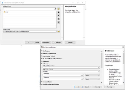

PhilipHardy
I did find a solution that did what I needed.  I converted the XYM shapefile to an XYZM shapefile using this. I used the Feature Class to Shapefile tool in ArcGIS and selected the Environments button and set it to enable Z with a default of 0. The resultant shapefile has XYZM geometry.  I am sure the Environments button will work similarly with other commands as well.
