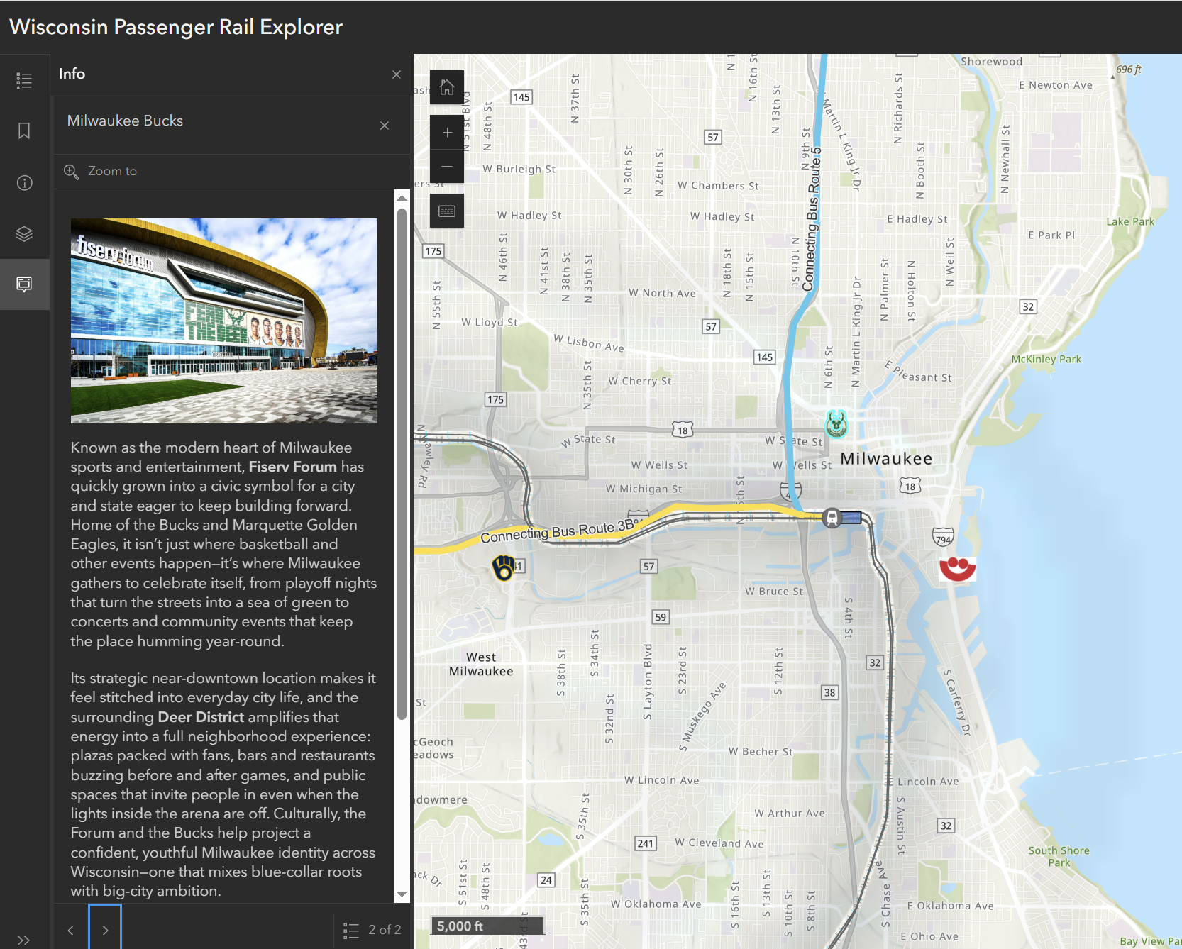

A rail vision without destinations is just lines. I added a Destinations point layer to illustrate the practical and cultural trips rail can unlock.
Examples include:
  • University hubs and campuses
  • Major sports/event destinations (Badgers, Packers)
  • Regional festivals and downtown cores
These features use custom icons and simplified fields to support rapid scanning in popups.
Figure 3: Destination layer close-up: Milwaukee's Fiserv Forum.

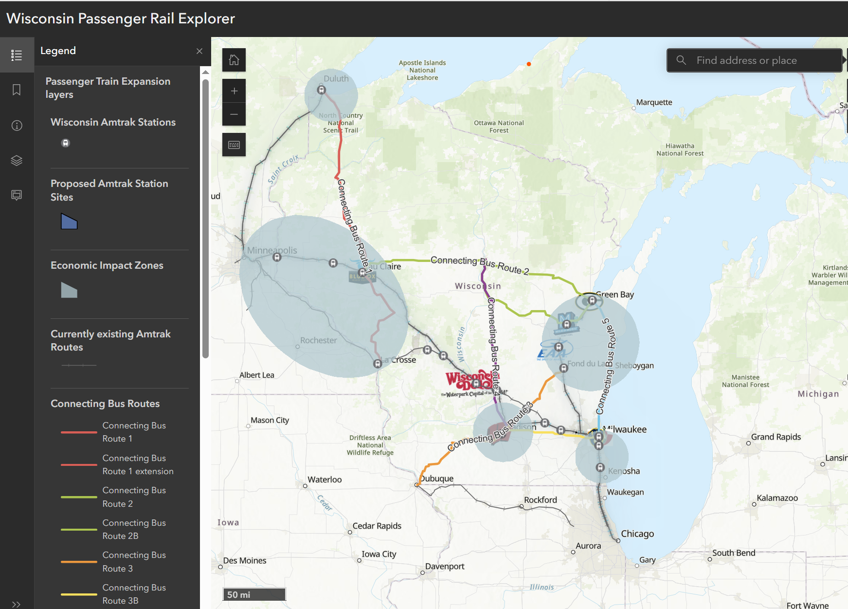

Wisconsin view
The Wisconsin-focused experience is organized around three layer groups:
  1. Rail Lines
    • Existing Amtrak service
    • Proposed corridors traced over current infrastructure
    • A Madison-centered vision connecting Green Bay, Eau Claire, La Crosse, and the Superior/Duluth region
  2. Destinations
    • Custom iconography for major cultural/economic hubs
    • Built to answer: “Who benefits and which trips become easier?”
  3. Economic Impact Zones
    • Conceptual buffers representing corridor influence
    • A structured way to talk about downstream impacts without claiming precision
This view is designed to be intuitive for non-GIS users. The story moves from networkplaces worth traveling towhy these lines matter.

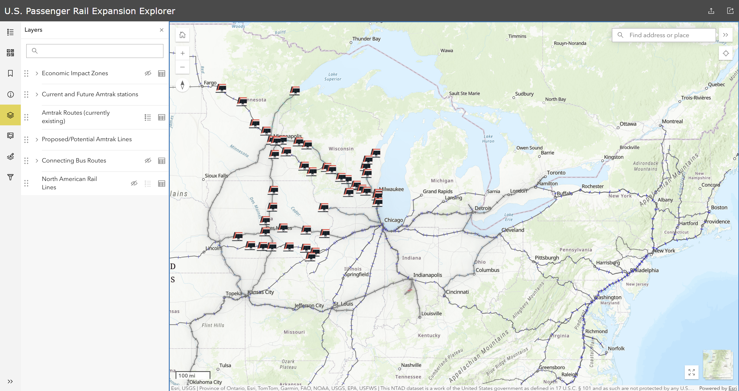

National view
The national view broadens the lens. Layers are grouped by region and system role:
  • Amtrak Midwest
  • Amtrak South
  • Other national expansions / backbone corridors
The point isn’t to predict a federal master plan. It’s to show coherence—that Wisconsin corridors only reach full value when they connect to a national spine.
