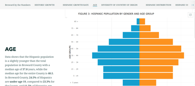

@ChristineBaver @EricaNova I don't have a blog post on this, but i can share the code of one my R Shiny Apps that's a web application showing interactive Pyramid plots of Hispanic Population. This web app was then embedded as an iframe into a ESRI web application. If you would like to have the data behind this app to play and learn the code, please dm me, and i can share it with you 🙂.
App URL: https://saadib.shinyapps.io/PopulationPyramidPlots/
R Shiny Web App Embedded in StoryMaps: https://storymaps.arcgis.com/stories/885ec2e2359d48bab885da95d20fa810

I love R and imo its plotting capabilities are much better than Python. For static R plots you can insert them as images, but for dynamic/interactive plots like something created using ggplotly, what i usually do is that i create a tiny R Shiny Web App of the plot(s) and embed them into ESRI webapps such Dashboards using an iframe.
The only ESRI webapp/desktop dashboard that is well integrated with R is Insights, you can look into that, but unfortunately Insights is getting deprecated, which is a real bummer.
Hope this helps,
Happy Plotting 🙂
