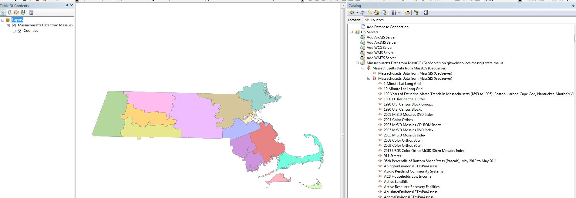

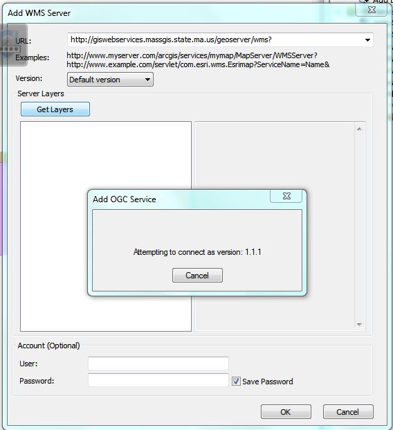

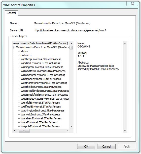

I can use this service from ArcMap when I add as WMS Server from GIS Server.And then I drag and drop one layer(Counties) in map .Here is below pictures:

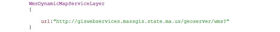

Here is below picture using with WmsDynamicMapServiceLayer in qt/qml app.

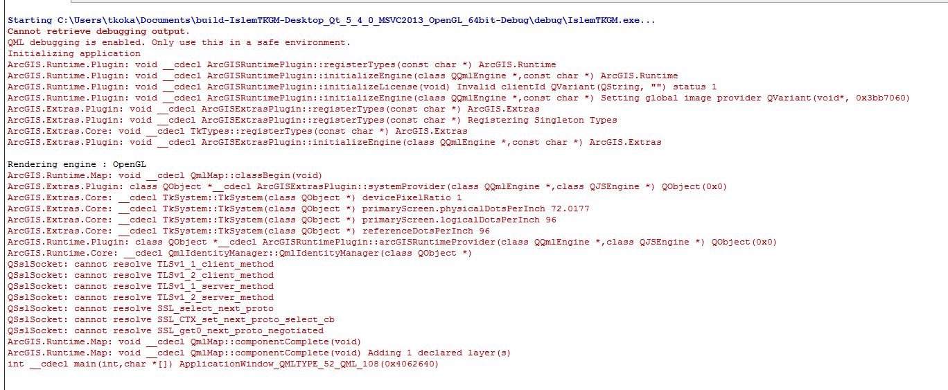

Here is below console output:
