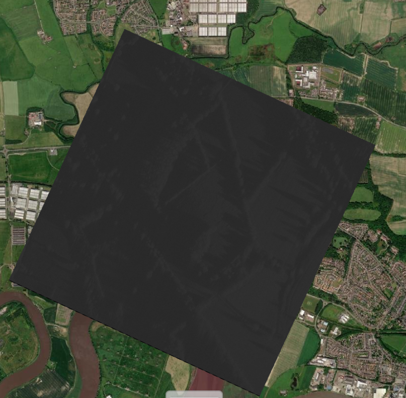

We are trying to load .ntf file on ArcGIS as raster image but we are not able to control the property of the image. Image is getting loaded as like raw image.

The gamma also functionality is not making any diff , please see the attached image.

Thanks for reaching out to the Runtime team. I can reproduce this problem and I will log it internally for us to investigate.
In the meantime, it does work for me if I change the gamma value after the raster loads. Can you try that and see if it works for you?
In your code it would be putting the "rasterLayer->setGamma(100.0);" call into the doneLoading lambda.
