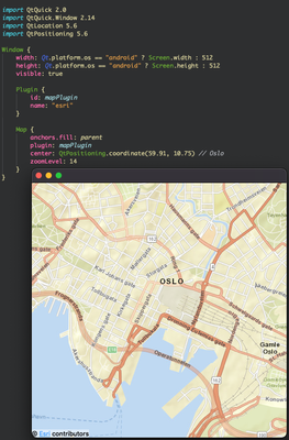

Hi @DevalGupta . I did a quick test on macOS and it worked for me, but I did not specify any PluginParameters.
As a starting point, see if you can get a map loading with that alone.
Here are more details about the "esri" plugin: https://doc.qt.io/qt-5/location-plugin-esri.html. This will provide more details on what is required.
Screen Shot 2023-06-01 at 12.47.59 PM.pngScreen Shot 2023-06-01 at 12.47.59 PM.png

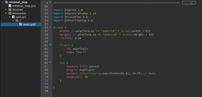

I am running on linux, and my code looks the exact same and it is not working.
Screenshot 2023-06-01 at 1.00.38 PM.pngScreenshot 2023-06-01 at 1.00.38 PM.png

@DevalGupta I tried on Linux and I get the same thing.
I checked the network requests and this logic is using the older, non-https endpoints by default. For example this request goes out for a map tile:
http://services.arcgisonline.com/ArcGIS/rest/services/World_Street_Map/MapServer/tile/15/9530/17362
ArcGIS Online returns a 301 redirect for the https endpoint version and that works fine on macOS. I don't know for certain, but I suspect there could be a problem with the SSL configuration on Linux with Qt 5 since that would be required for the https tile endpoints, or the networking is getting tripped up by the 301 redirect. I suspect the SSL issue.
