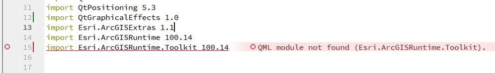

Hi,
I  using ArcGIS_Runtime_SDK_Qt_Windows_100_14_0 sdk. Im  using Qt Creator 7.0.2 Based on Qt 6.2.3 (MSVC 2019, 64 bit)  and Kits Qt 5.15.2   (Android  Clang Multi -Abi and  MinGW 64-bit ) .
I want to use Callout as in this example Show callout  in my project but I can not use Esri.ArcGISRuntime.Toolkit 100.14 library like below in picture. How can I solve this problem ?
Thanks
Gela
by Esri Alum
Esri Alum
Sounds like this could be related to your directory path being too long. Unfortunately, by default Windows will drop characters after a certain length if the path is too long which can result in this. To work around this, there are 2 options:
1. Enable long paths on your Windows machine. Instructions to do that can be found here.
2. Change the shadow build directory to a much shorter path like "c:\tempbuild" and try to rebuild again.
Let me know if either of these work or if you continue having issues.

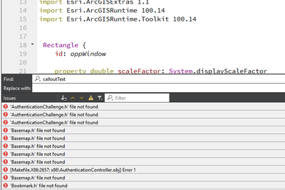

tanerkoka
Thanks for answering Gela.
Not found Toolkit problem was solved but I can't build my app. Here is problems below in picture.
Gela
by Esri Alum
Esri Alum
