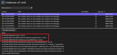

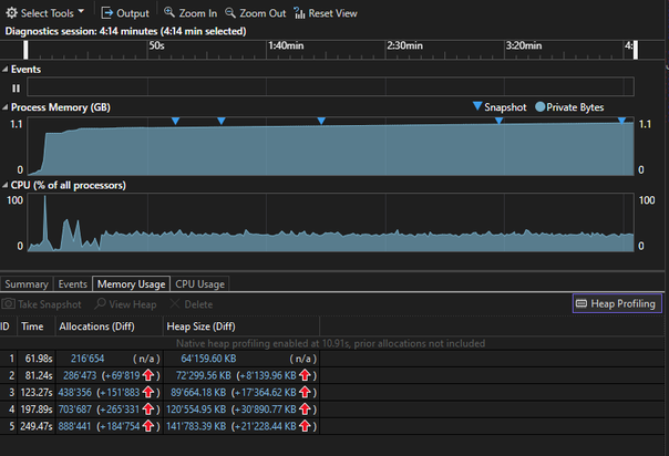

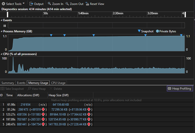

We created following snapshots of the memory, as you can see with increasing memory.

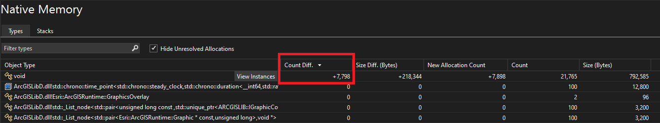

Here's the allocation diff showing that many new pointer objects were created.

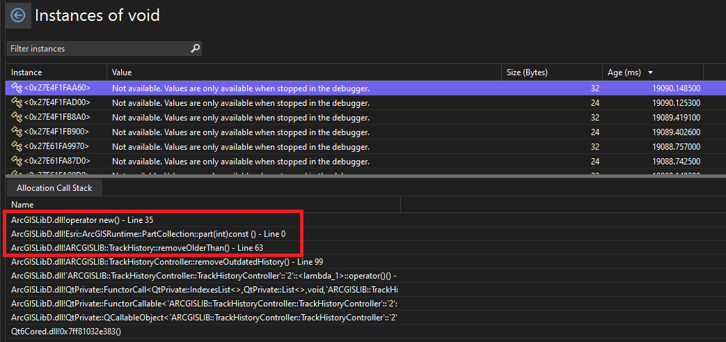

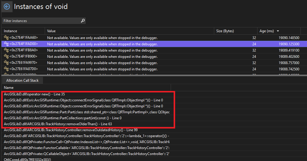

Looking at the instances we see that almost all of the new allocations come from PartCollection::part(int index). Here's the first allocation:
And here's the second allocation:
