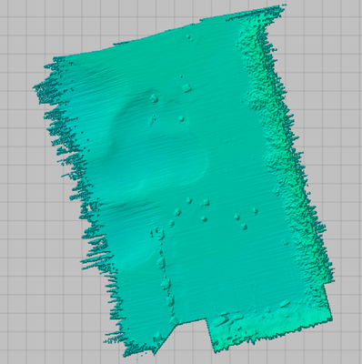

The result is the following:
Which is not displayed as I expect it because the non-covered area of the seabed is also painted.
I have two questions:
  1. How can I make the NaN values transparent?

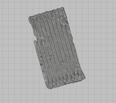

Hi @apalomer-iqua.
I pulled down your test project and got it built locally. I was going to recommend using a raster mask function, but it looks like you beat me to it here: https://bitbucket.org/apalomeriqua/arcgis_test/src/24056f737a006278fa6ff7934d83e129bbd1b4ee/src/test...
Testing it out locally with version 200.6.0 does have the desired effect for me on macOS. It should be the same on Linux or other platforms as well.
And with the basemap present and all layers visible:
Is this what you were trying to achieve?
