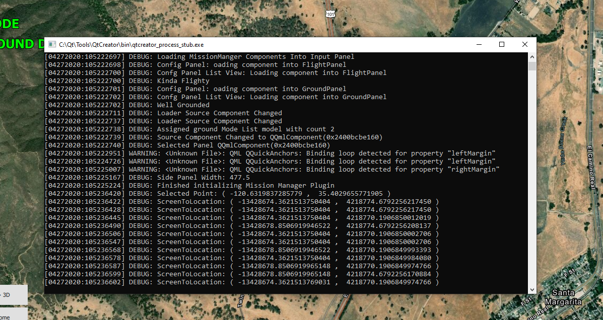

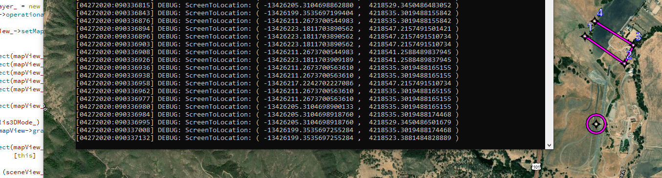

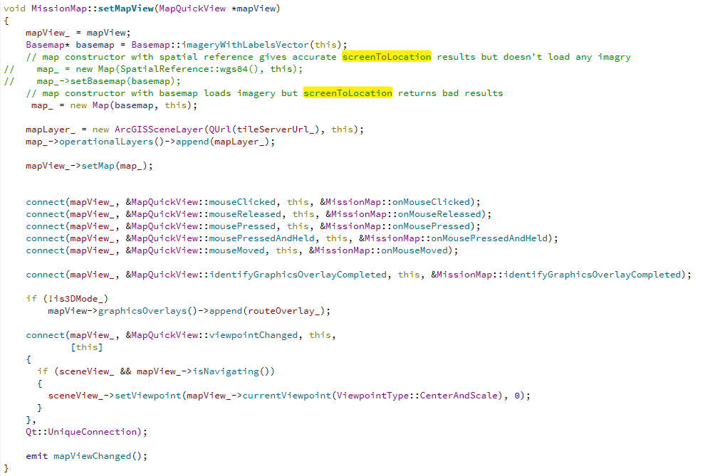

I noticed that screenToLocation was returning some bad values.  While tracking that down I learned that spatial reference is an important factor here for getting correct results.
If the spatial reference is set using the Map class constructor then I get correct results from screenToLocation, which is great!  The bad news is that map imagery no longer loads. I only get map imagery if use the Map class constructor that takes a basemap.  Setting basemap after construction is not working either to get the imagery to load.
I cannot find any way to set the spatial reference for the map other than at construction.
How can I get this to work?

I noticed that I was using ArcGISSceneLayer with a MapView so I did change it to ArcGISMapImageLayer but the same problem is still present.
Using:

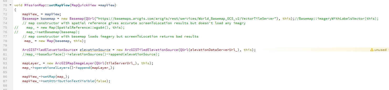

    map_ = new Map(basemap, this);
Using
    map_ = new Map(SpatialReference::wgs84(), this);
    map_->setBasemap(basemap);

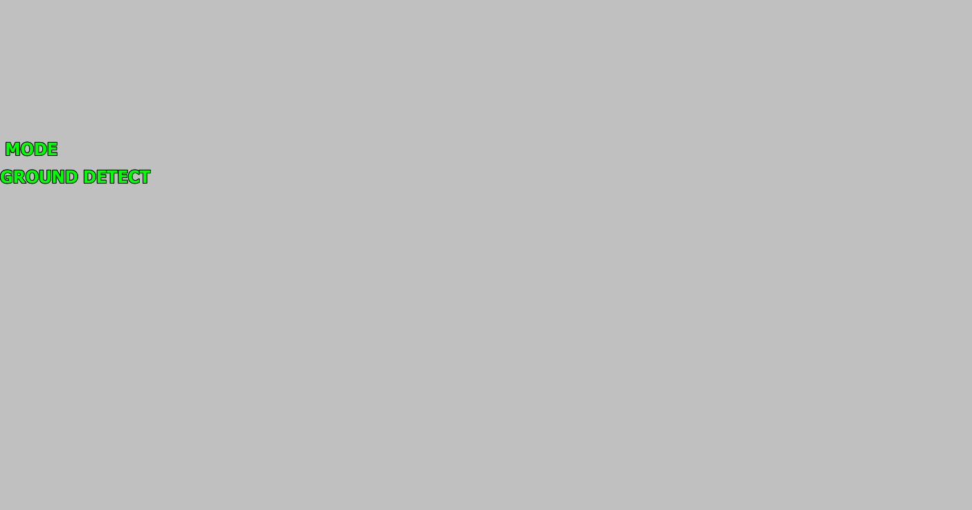

Here is the code where I'm assigning the basemap the URL from your link:
I end up with gray rectangle without even any gridline:
Am I not using the correct URL? Or maybe I'm not creating the basemap correctly?

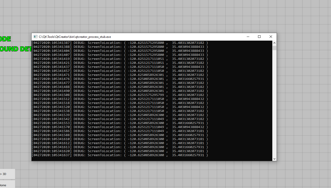

I did detect my spatial reference WKIDs for the map view and the scene view.  I get the following results:
I'm not sure what that means to have a reference of -1 but it doesn't seem good.  The point returned by the MapQuickView::screenToLocation() method has a WKID of 3857 (WGS_1984_Web_Mercator_Auxiliary_Sphere ).

auto vtl = new ArcGISVectorTiledLayer(QUrl("https://basemaps.arcgis.com/arcgis/rest/services/World_Basemap_GCS_v2/VectorTileServer"), this);
auto basemap = new Basemap(vtl, this);
m_map = new Map(basemap, this);
