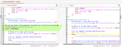

I just had a look at our silent installer for 100.14 where we modified a copy of the Setup script to set and export an IATEMPDIR=$Esri_Install_Directory inside the append_to_install_dir function.  Then calling that with "./Setup.modified -s" gets the silent install to work for us.
I think your attempt to call install.bin manually didnt work right since you didnt provide a -f "$Esri_Silent_Property_File" argument to it for writing the esri properties file to a specific location that is used later when compiling the sample.
