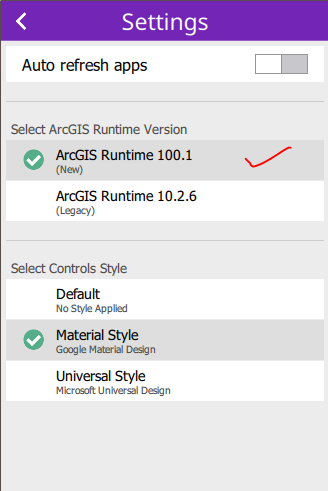

One more thing I forgot to add that AppStudio Player 2.x supports both 10.2.6 and 100.1 Runtime. But in order for it work correctly. Please choose the correct Runtime version in the Player settings. Once you select it. It will ask you to restart the player.

AneeqaAbrar1
Yup, did all of that. Version 2.0.26 and the runtime is 100.1.
