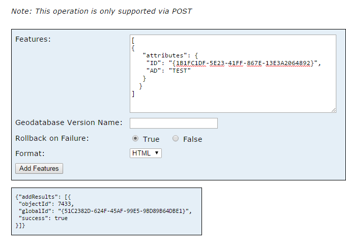

I have rest service type Table without geometry. It is not feature class is only table.How can I create new row and add in Table ,are there any wrong code below?.I can create in rest services but in qml not Here is the qml code, console output and rest service part below:

Rest Part:

Based on your screenshots, it looks like the service supports it, but the API does not like it for some reason. I recommend you contact Esri support/your Esri distributor to log a bug. This looks like it is an issue on the Qt side.
