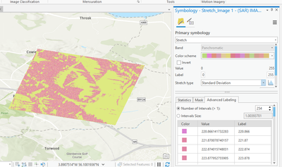

I'm trying to convert a grey scale image to RGB, but not able to do so over Qt SDK.

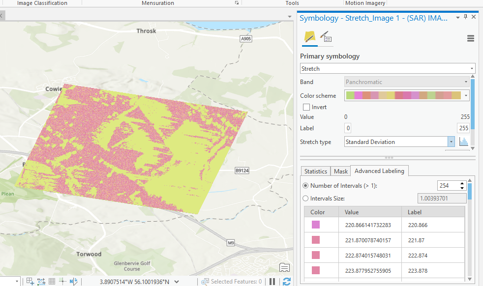

I was able to convert in ArcGIS pro as follows:
  1. .nitf->Input to STRETCH Raster function with Minmax->this give  me a stretch_raster layer.
  2. new Stretch raster layer-> changing symbology by changing color map.
  3. The resultant is shown below

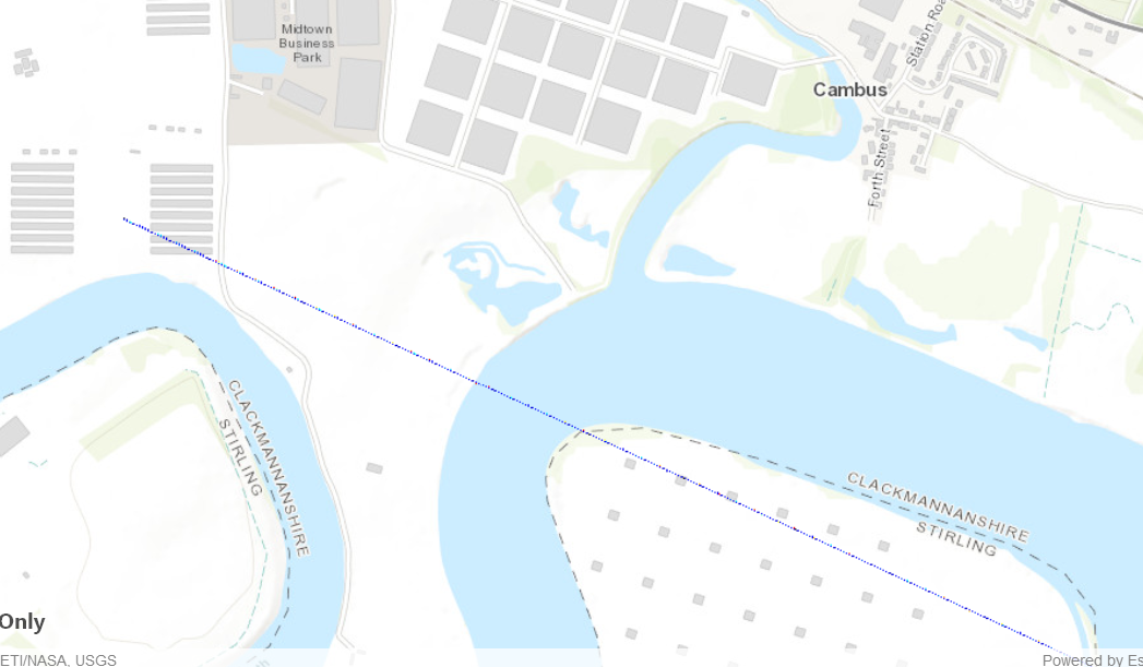

 But samething I'm trying over qt code, I'm not able to do so color map rendering on raster file gives me below output, just single line.
does anyone faced similar issue and guide me. If required I can share code.

Can you share some of your code for creating the renderer & layer?
TASL_Virendra
Hi Lucas,
Please find the code in attached file.
It is a trial project, so ignore the coding standard and stuff.
Thanks
Virendra
LucasDanzinger
Esri Frequent Contributor
Your code sample reads color values from a text file. What does your `QList<QColor> colors` end up containing?
