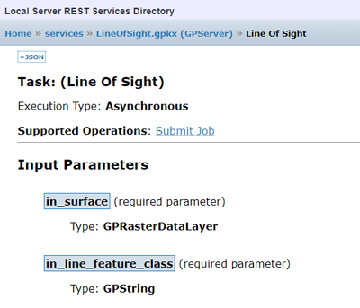

Interestingly enough, when navigating to the task on the local server it says it expects a GPString, I assume the GeoprocessingFeature that I use as input is converted to a GPString automatically. But I'm not sure how I could do the same with a FeatureLayer.

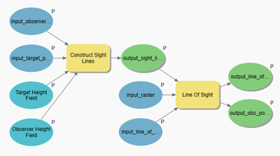

Thank you for the reply. I haven't tried your idea with the json conversion tool yet, but thanks to your reply I looked a bit more into how to create your own model in ArcGIS Pro since I've never done that before.
What I came up with is using two tools in sequence. First `Construct Sight Lines`, its output is of type ` Feature Class`, so that should be a match. The resulting sight line is the input for the Line Of Sight tool.
Now all I have to provide from the runtime are 1 target point, 1 observer point, and the input elevation raster.
Not sure if this is the optimal solution, or if this is really necessary just to use the Line Of Sight tool. Maybe it would be simpler with the json conversion tool, I'll try that later.
