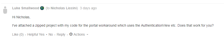

LukeSmallwood
Hi Nicholas,
I've attached a zipped project with my code for the portal workaround which uses the AuthenticationView etc. Does that work for you?
NicholasLiccini
Yes that would be great! Where can I find the .zip file?
LukeSmallwood
I attached it to my reply above - are you not able to access that?
NicholasLiccini
Hmm, it's not visible for me to download there

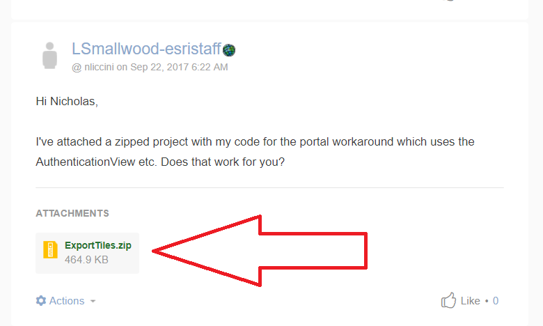

LucasDanzinger
Esri Frequent Contributor
I can see the zip:
NicholasLiccini
Hmm, this is strange. All I see is the text from the post still:
