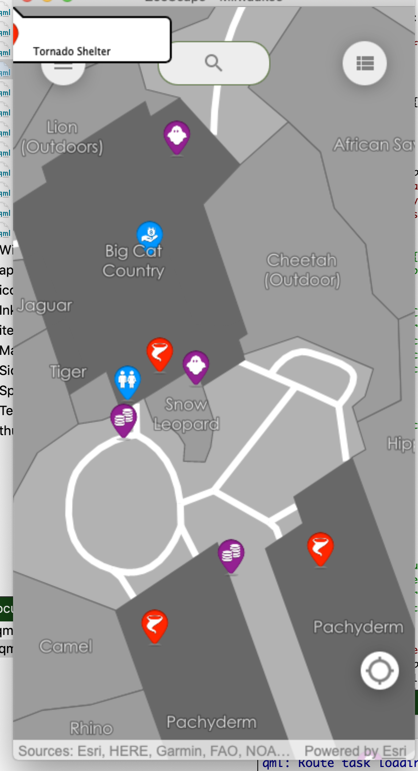

I've followed a couple Callout samples when creating my own but I can't get the location of the callout to display where I clicked or the xy coordinate of the feature I am selecting.  Every time the callout displays in the upper left of the screen like below:
Callouts appear to be pretty straightforward so I'm not sure why I can't get mine to work.  (I am using a mmpk)
property Point clickedPoint
calloutData {
Callout {
        calloutData: parent.calloutData
        accessoryButtonHidden: true
        leaderPosition: leaderPositionEnum.Automatic
onMouseClicked: {
        clickedPoint = mouse.mapPoint;
        var tolerance = 5,
        returnPopupsOnly = false,
        maximumResults = 1;
        mapView.identifyLayerWithMaxResults(featureLayer, mouse.x, mouse.y, tolerance, returnPopupsOnly, maximumResults);
onIdentifyLayerStatusChanged: {
         if (identifyLayerStatus === Enums.TaskStatusCompleted) {
             featureLayer.clearSelection();
             const elem = identifyLayerResult.geoElements[0];
             const count = identifyLayerResult.geoElements.length;
             featureLayer.selectFeatures(elem);
             var featureName = elem.attributes.attributeValue("Name");
             var xcoord = elem.attributes.attributeValue("POINT_X");
             var ycoord = elem.attributes.attributeValue("POINT_Y");
             mapView.calloutData.geoElement = elem;
             mapView.calloutData.detail = featureName;
             mapView.calloutData.location = clickedPoint;
             callout.showCallout();

Thanks for reaching out to the team. In our example code, the "parent" is the MapView object. I can't tell from your code if that's the case, but can you double check that?
This might work:
calloutData: mapView.calloutData
TimConfare1

Yes, the parent is the MapView object in my code.  I did change that line to mapView.calloutData but it does the same thing.
Any other ideas?
Thanks!

Do you get any errors in your console about undefined references or anything like that? I took your code and added some layers and was able to get it to work as expected:
import QtQuick 2.6
import QtQuick.Controls 2.2
import Esri.ArcGISRuntime 100.9
import Esri.ArcGISRuntime.Toolkit.Controls 100.9
ApplicationWindow {
    width: 800
    height: 600
    title: "Test"
    // add a mapView component
    MapView {
        anchors.fill: parent
        // set focus to enable keyboard navigation
        focus: true
        // add a map to the mapview
        Map {
            // add the BasemapTopographic basemap to the map
            BasemapTopographic {}
            FeatureLayer {
                ServiceFeatureTable {
                    url: "https://sampleserver6.arcgisonline.com/arcgis/rest/services/DamageAssessment/FeatureServer/0"
        calloutData {
        Callout {
        onMouseClicked: {
            var tolerance = 5,
            maximumResults = 1;
                //                var featureName = elem.attributes.attributeValue("Name");
                //                var xcoord = elem.attributes.attributeValue("POINT_X");
                //                var ycoord = elem.attributes.attributeValue("POINT_Y");
                //                mapView.calloutData.detail = featureName;
TimConfare1
Thanks for the reply.  I do not have any errors in my console.  The only thing different with our code is that I am using a mmpk instead of pointing to a service.  I thought maybe it had something to do with spatial reference since my POI layer (which is the geoElements layer) is in a different coordinate system than the basemap and the data frame.  I projected that layer to the same coord system but it still puts the callout in the upper left.

Can you share your code that gets a reference to the featureLayer?
TimConfare1
Map{
        MobileMapPackage {
            path: filePath + inputdata
            Component.onCompleted: {
                mmpk.load();
            onLoadStatusChanged: {
                if (loadStatus === Enums.LoadStatusLoaded) {
                    mapView.map = mmpk.maps[0];
                    mapView.map.minScale = 15000;
                    mapView.map.maxScale = 1000;
                    var identLayerList = mmpk.maps[0].operationalLayers;
                    featureLayer = identLayerList.get(app.idOfPOI);
                    var identLayerName = featureLayer.name;
                    var featureTable = featureLayer.featureTable;
                    console.log("Identify Layer name is " + identLayerName);
                    mapView.setViewpointScale(initialScale);
                    locationDisplay.start();

I tried that and the following code worked for me as well. Does this work for you?
import QtQuick 2.6
ApplicationWindow {
    width: 800
    height: 600
    title: "test"
    property FeatureLayer featureLayer
    MapView {
        focus: true
        Map {
            MobileMapPackage {
                path: "file:///Users/luca6804/ArcGIS/Runtime/UnitTests/mmpks/advancedSymbols.mmpk"
                    mmpk.load();
//                        mapView.map.minScale = 15000;
//                        mapView.map.maxScale = 1000;
                        featureLayer = identLayerList.get(0);
                        //mapView.setViewpointScale(initialScale);
                        //locationDisplay.start();
        calloutData {
        Callout {
        onMouseClicked: {
            var tolerance = 5,
            maximumResults = 1;

I copied your code exactly and my callout is still in the upper left.
LucasDanzinger
Esri Frequent Contributor
Are you able to share any data? That's the last major difference in our testing that I can think of. Alternatively, can you try my code with the feature service and see if that works for you?
