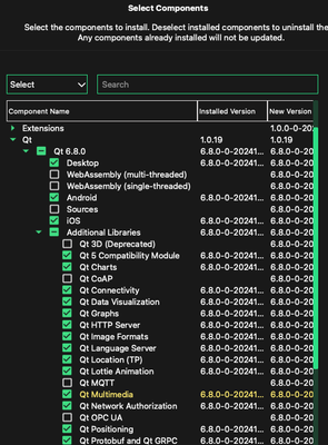

I tried a 200.5.0 template with Qt 6.8.0 on macOS (albeit using Xcode 15.2) and it links ok. Can you confirm if you installed the multimedia library with Qt 6.8.0? If you're upgrading from Qt 5, Qt moved some of the extra pieces into the "Additional Libraries" section with their installer. We do require a few of these, including Multimedia.
Note this screenshot is not our requirements. It's just an example. We do require (at a minimum), positioning,  sensors,  multimedia, and websockets Qt libraries.
