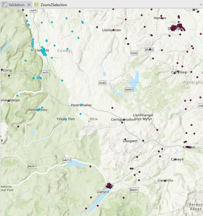

So I have a map (it is a map view as it is open) called Validation and it has some selected point features in it:

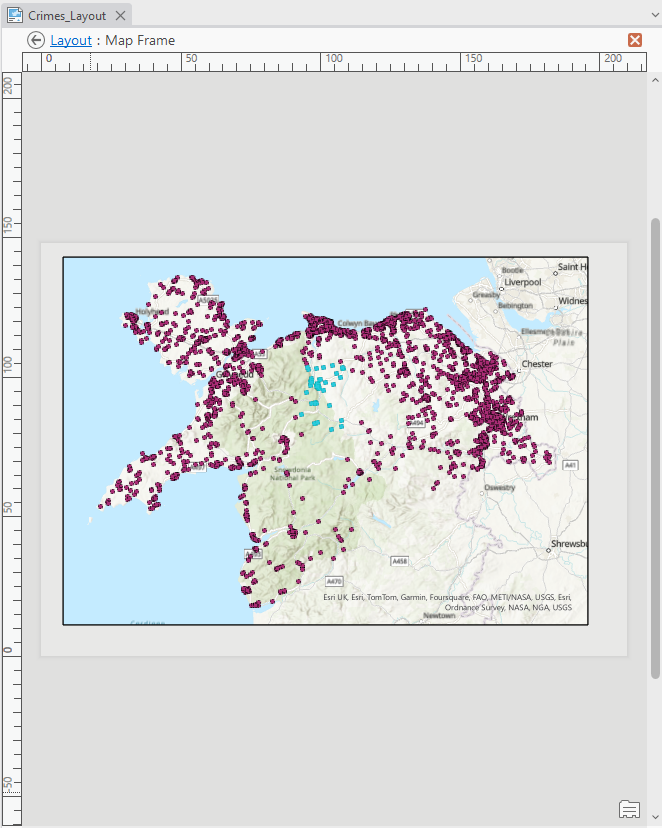

I also have a layout called Crimes_Layout. This layout has a single Map Frame. That map frame is looking at the Validation map (notice the same selected features in the layout...):

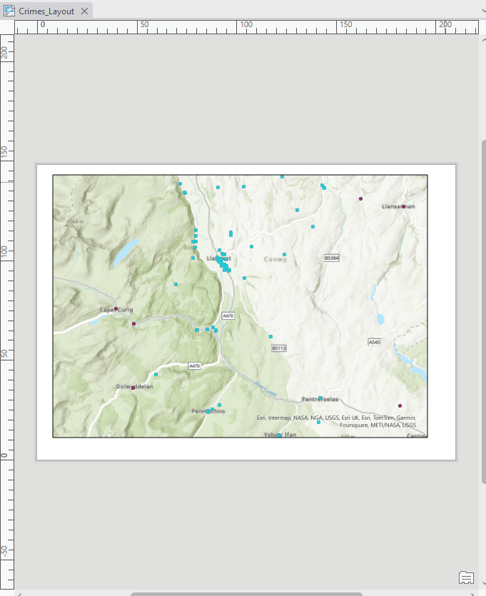

When I click on my layout and I then run the code in my notebook, which I supplied previously, the map inside of the map frame (which is inside of my layout) zooms to the extent of the selected features in my map:
I think the order in which you click on the layout tab and then the notebook is important.
