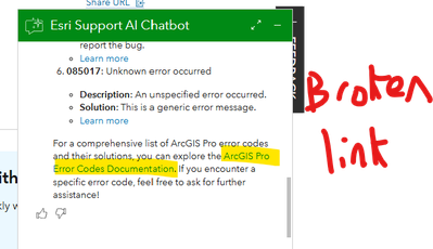

Even the AI chatbot says there should be a list.
