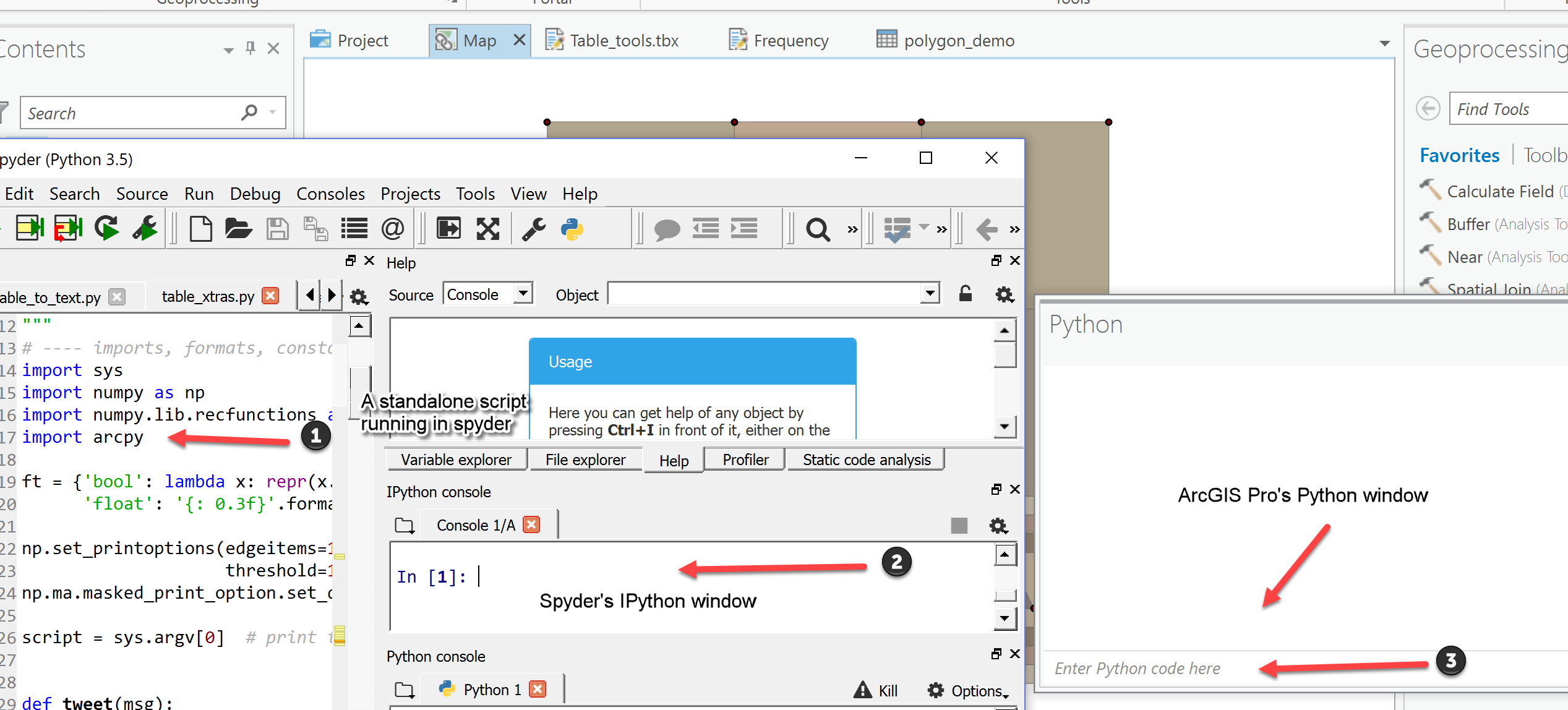

I have 3 incarnations open.  ArcGIS Pro's builtin python interface, Spyder's IPython command line window and a standalone script.
Depending on what I am doing I can use several of these to process work.  Working with an external IDE like Spyder allows you to connect with ArcMap or Pro easily while doing pure python related stuff at the same time.  here is an image
