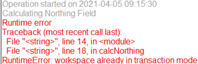

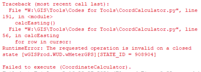

Hello everyone,
I am getting  the following error after running my script:
The script runs fine when I am not in a version but once I change it to a version, it breaks after the first UpdateCursor.  Note: the imported "cursors" module is from this post:  https://community.esri.com/t5/python-questions/the-requested-operation-is-invalid-on-a-closed-state/...

EvanMyers1
So after moving my edit start and stop sessions to every conceivable combination, I decided to take a look at the custom cursor module again since it starts and stops for me.  After some research, I found some changes to the cursor module.  Well, lo and behold, I got my code working again.
Thanks all for your help!

DavidPike
MVP Notable Contributor
you tried the stopediting(true) then starting editing again as per the post?  I have seen some issues using the 'with' statement also, perhaps try the cursors without that.  unaware of the cursors module bit will have a look.
JoeBorgione
MVP Emeritus
I'm not familiar with importing the cursors module. Instead I suggest you use the da.UpdateCursor.
When editing an enterprise geodatabase (aka SDE), you need to start an edit session and close it it as well:
ws = r'X:\some\path\to\your\enterprise.gdb'
edit = arcpy.da.Editor(ws)
edit.startEditing(False,False)  #see the documentation on the parameters
edit.startOperation()
with arcpy.da.UpdateCursor(blah, blah bla) as cursor:
    for row in cursor:
        blah blah blah
        cursor.updateRow(row)
edit.stopOperation()
edit.stopEditing(True)
@DavidPike , using 'with' in any da cursor is traditionally the way to go; I've used that approach hundreds of times without an issue...
That should just about do it....

EvanMyers1
So maybe I am misunderstanding something about edit sessions within functions.  Right now I tried testing it like this but I now get this error:
def calcNorthing():
try:
# calculate northing
edit.startEditing(False, True)
if 'Northing' not in lstFields:
arcpy.AddField_management(userInput, "Northing", "DOUBLE")
print("Calculating Northing Field")
arcpy.AddMessage("Calculating Northing Field")
with arcpy.da.UpdateCursor(userInput, ['Northing', 'Shape@'], "Northing IS NULL") as cursor:
for row in cursor:
if row[1] is not None:
pt = row[1].projectAs('2236').centroid
row[0] = round(pt.Y, 3)
print("Completed Northing calculation")
arcpy.AddMessage("Completed Northing calculation")
# del cursor
except():
arcpy.AddMessage("Failed Northing calculation."

DavinWalker2
Do you have an edit session started in any Desktop GIS software (ie ArcPro or ArcMap)?
EvanMyers1
I did not.  Right now my code works correctly whether or not I am in an edit session.
JoeBorgione
MVP Emeritus
The only thing I can think of is perhaps make your edit calls outside of the try/except block:
