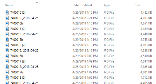

Hello,
I have a lot of JPEGs in a Windows directory. In most cases these JPEGs do not have similar filenames. On the other hand, there are some repeats:
Using exifread, I'm appending the 'date taken' to the end of the seven digit number of the filenames. This script gets me close, but it's not exactly doing what I want. It skips the files with similar names (e.g. 7400010 (2), 7400010b). Also, after running the script I'm having trouble avoiding the '.' of the file extension. Ideally, I'd like every filename to have this structure: 7400010_2018-04-25. And as far as the files with similar names goes, how do I preserve the (2) and the b?

Here's how the filenames look after running this script:

JaredPilbeam2
MVP Alum
Joshua,
that appended JPG to the end of the date and skipped the repeats:

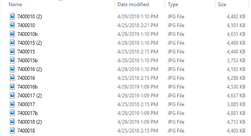

JaredPilbeam2
MVP Alum
Randy,
that works nice, but is it possible to put the whole directory into a list?
JaredPilbeam2
MVP Alum
I tried this, but the repeats were still skipped:
for root, dirnames, filenames in os.walk(im): #iterate directory
    for fname in filenames:
        if fname.endswith('.JPG'):
            with open(os.path.join(root, fname), 'rb') as image: #file path and name
                exif = exifread.process_file(image)
                dt = str(exif['EXIF DateTimeOriginal']) #get 'Date Taken' from JPG
                ds = time.strptime(dt, '%Y:%m:%d %H:%M:%S')
                nt = time.strftime("%Y-%m-%d",ds)
                newname = fname[:-4].replace(' ','_').replace('(','').replace(')','').replace('.','') + '_' + nt + ".jpg"
                print(newname)‍‍‍‍‍‍‍‍‍‍
prints:
7400017_2018-04-25.jpg‍‍‍‍‍‍‍‍
