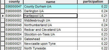

I have been given a shape file and some .CSV's, i need to workout the average value for a field in a given  polygon using python
CSV's:
  • LAD_to_LAU1_to_NUTS3_to_NUTS2_to_NUTS1_January_2018_Lookup_in_the_UK.csv
  • SportsStatisticsforPython
the two CSV's  join well using the ArcMap UI, however when running the join tool both from the Data Management toolbox and the in ArcMap Python Console i get the following error after trying to link "counties" of the SportsStatisticsforPython.csv to the "LAU118CD" field of LAD_to_LAU1...etc (see screenshots at the end of post)
ExecuteError: ERROR 000339: Input LAD_to_LAU1_to_NUTS3_to_NUTS2_to_NUTS1_January_2018_Lookup_in_the_UK.csv does not have OIDs Failed to execute (AddJoin).
can someone explain why its not working and how could go about fixing it, preferably in Python 2.7 as i will need to write a script that joins them together then finds the mean participation value for each county, which will then need to be linked to the relevant county in my shape file.

SportsStatisticsforPython.CSV

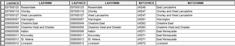

LAD_to_LAU1..etc...etc..

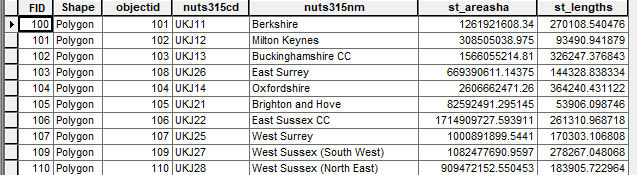

Shape File Attribute Table
