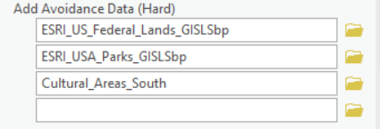

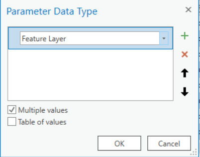

In the Validation tab in Tool Properties, I added a list of feature class to parameter #12 in the UpdateParameters function. The feature classes from the list were successfully loaded to in the prompt, but I'm not able add new values or delete values in the tool interface. As the first screenshot shown below, I couldn't delete any of the three or add a new value.  I set the parameter as Feature Layer and checked the multiple values box. Is there any setting or any coding needed to enable user to add and delete values?
