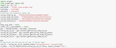

I am a bit new to python in Arcgis, and I would need help.
I would like to update a csv automatically, based on a feature layer data. I am doing this currently by exporting the feature layer data manually, running a script that reads it, remove duplicates and writes a csv file in my folder and then I upload the file in Arcgis to update my arcgis online csv file.
I would like this to be done in Arcgis Online automatically without having to run the treatment on my computer. I have the feeling the notebook functionality could help but I have no idea what would be an appropriate script.
Can you help ? Thank you in advance 🙂

Thank you so much for your replay. I think I am almost there. I extracted data from survey123 in csv format.
Now, i would like to directly write the item ct_data in Arcgis, without having to write it on my local computer first : is it possible ?
OumaimaBoukamel95
An addition : I realized that running this script actually, generated the corresponding csv file on Arcgis Online. However, everytime I re-run this, it doesn't overwrite the csv file : it writes a new one. How can I make sure each time I run this script, the csv file is overwritten ? Also, is there a way I can write this csv file in a specific folder in Arcgis ? Thank you so much
