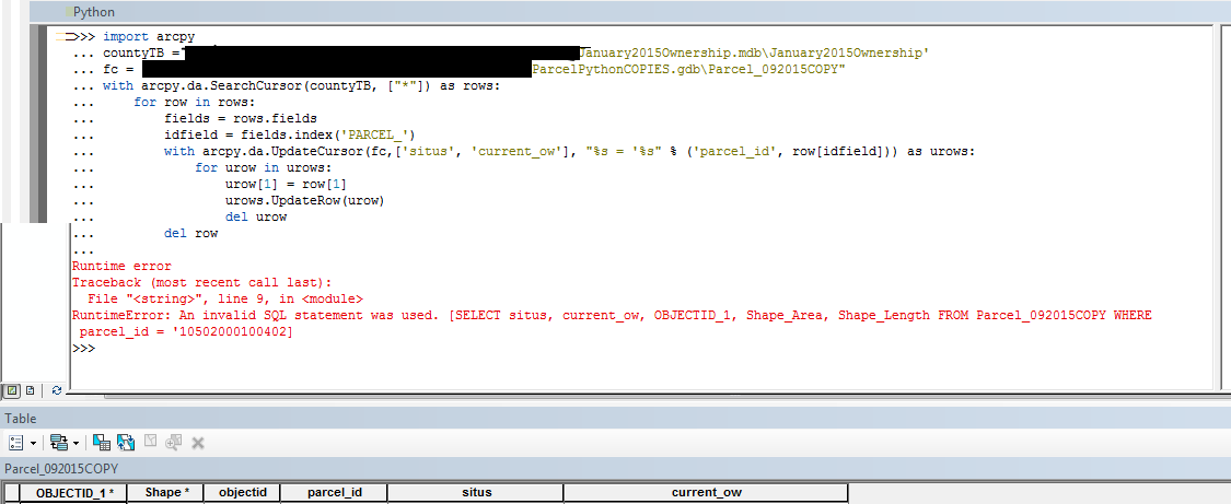

I'm new to python so forgive me if this seems like a dumb question... I work for the city and we get parcel information monthly from the county. Usually the data comes in a text file which I then put in an mdb. I'm trying to write some code to run an update our layers with the updated monthly information. Currently, I've just been trying to get a few fields to update  inside a 'test' file geodatabase but I'm stuck. I get the following error message with the following code. Any ideas?

Not sure about the rest, but you don't have the same number of single and double quotes.
BrianLomas
Oops I forgot I corrected that one... When that is taken out I get the following error...
Runtime error
  File "<string>", line 9, in <module>
RuntimeError: An invalid SQL statement was used. [Parcel_092015COPY]
DarrenWiens2
MVP Alum
Try building your SQL expression in a previous line, then printing it to confirm that it is what you think it is.
