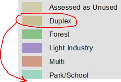

I am looking to rearrange classes in a SINGLE layer using arcpy mp.  Here's a visual sample only:

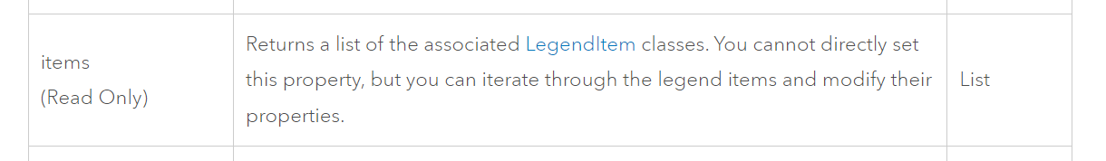

The documentation suggests LegendItems items is not settable (see image below) in basic arcpy.mp, although I did try and got an error suggesting the same.

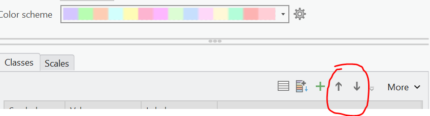

Bottom line is I'm looking to mimic/automate this GUI behavior from the symbology pane (or by right clicking a class > reorder (top, up, down, bottom).  Any tips would be appreciated.
