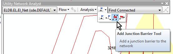

Using the ArcMap Utility Network Analyst tool bar I may manually 'Add a junction barrier to the network'  using the 'Add Junction Barrier Tool'. This allows me easily specify places where e.g. the 'Find Connected' Trace should stop.This is the ArcMap functionality that I want to script using Python/ArcPy
