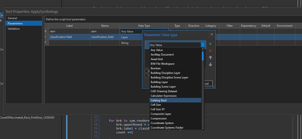

Hi,
I'm creating a script tool in Pro. What is the Data Type for a Pro project (*.aprx)? It would be the equivalent to the "ArcMap Document", I'd imagine.
I've looked for: aprx, project, pro project

File.

Thanks Dan. I looked at that one, but haven't got to it yet. Seems to be the right one.

@DanPatterson wrote:
File.
With the Filter set to "aprx"
