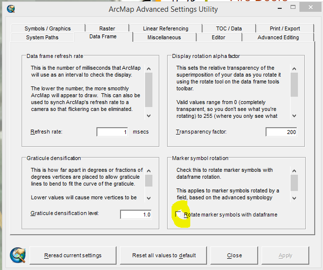

In several MXDs, I have symbology displayed based on a rotation field. In each MXD, I rotate the data frame based on the site plan. When I export to a PDF within ArcMap, the symbols stay rotated as they should.
I have already gone into ArcMap Advanced Settings Utility and checked off Rotate marker symbols with dataframe.

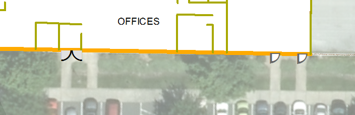

Sample when exporting to PDF from ArcMap:
When I use arcpy.mapping.ExportToPDF, the PDF exports correctly, but it will not honor the rotation. I would like to use Python because I have several dozen MXDs that will be updated on a monthly basis.

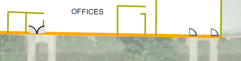

Sample when using arcpy.mapping.ExportToPDF

MartinEgger
You have to use 32-bit python when you execute the script. If you have installed 64-bit background geoprocessing then 64-bit python is used and rotation i not honored.
